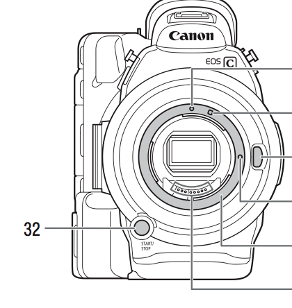

There are 2 things I wish they ( Canon ) would of done, added a Start / Stop button on the front lower left side of the camera and 1080 60p.
Leon Lorenz
Canadian Wildlife Productions: Grizzly Bears, Bighorm Sheep in Alberta & BC Rockies DVD Videos
Uhh...there is a Start/Stop on the front.

David, yes I know there is one on the front right, I would of liked one on the left front side as the camera is facing away from you.
