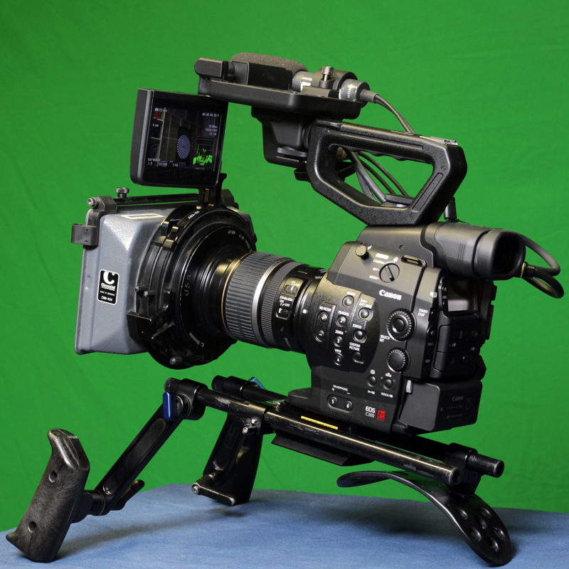

Re: Shoulder Rig
Here is the shoulder rig that Joe Sutherland Rentals use in Toronto. They already have 4 C300 cameras for rent and are waiting for a lot more. Joe also is promoting using the Easyrig Turtle X harness for reality TV.
Peter Mykusz is offline   Reply With Quote
