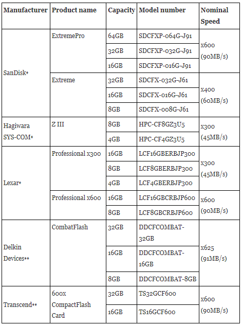

Bellow is a chart with supported cards.
But I guess any UDMA CF card with more then 45MB/Sec should work.
I'm going to use
1x Transcend CompactFlash Ultimate Card 600x, 32GB
4x SanDisk Extreme Compact Flash, 400x, 60MB/s, 32GB
