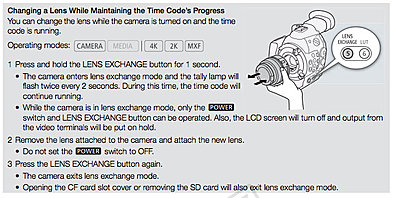

And to reinforce Canon's position on this, why do you think the C500 is like this now? (see pic)
CAUTION: 3rd party lenses-picture-11.jpg
David A. Fisher is offline   Reply With Quote
