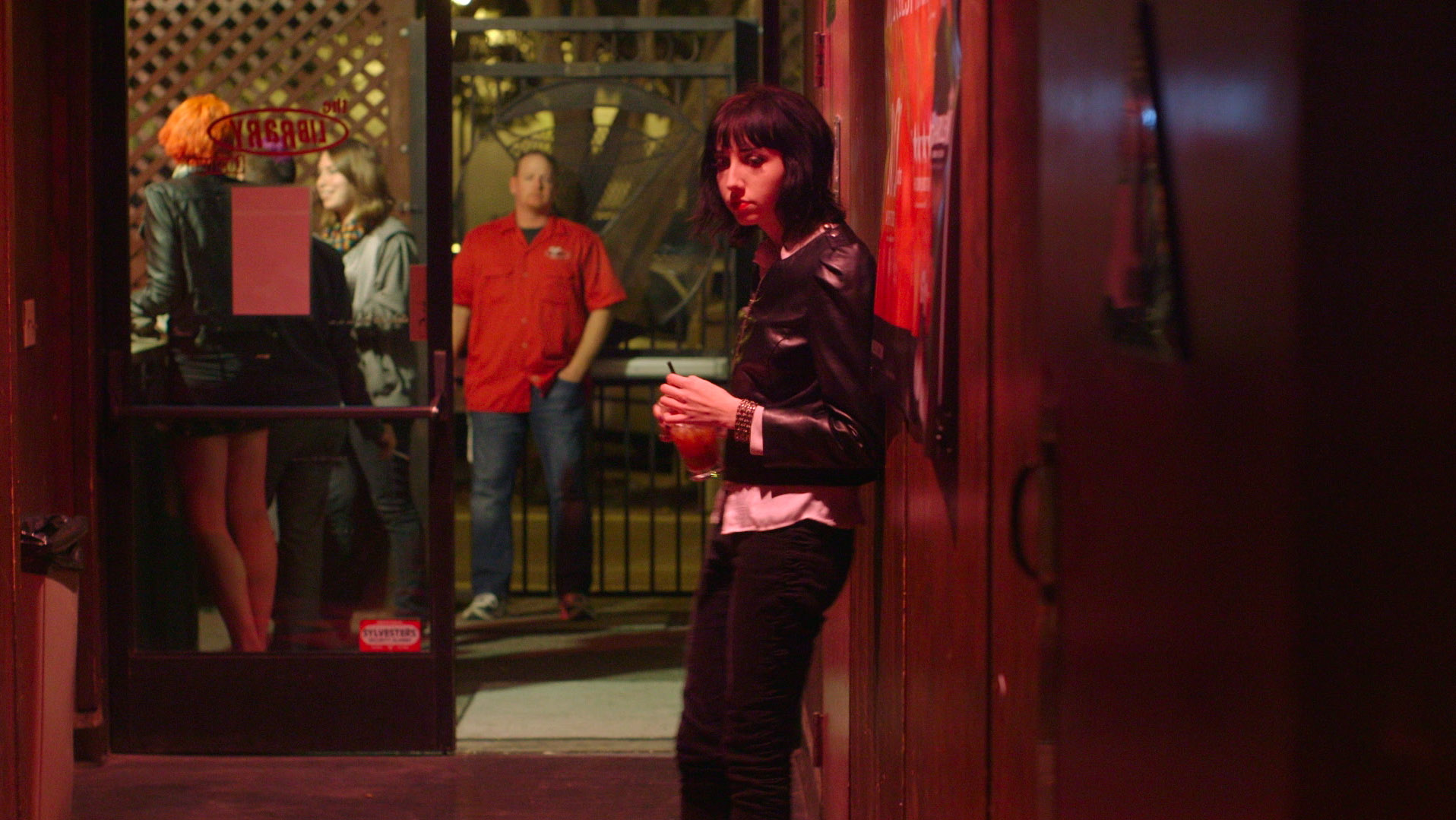

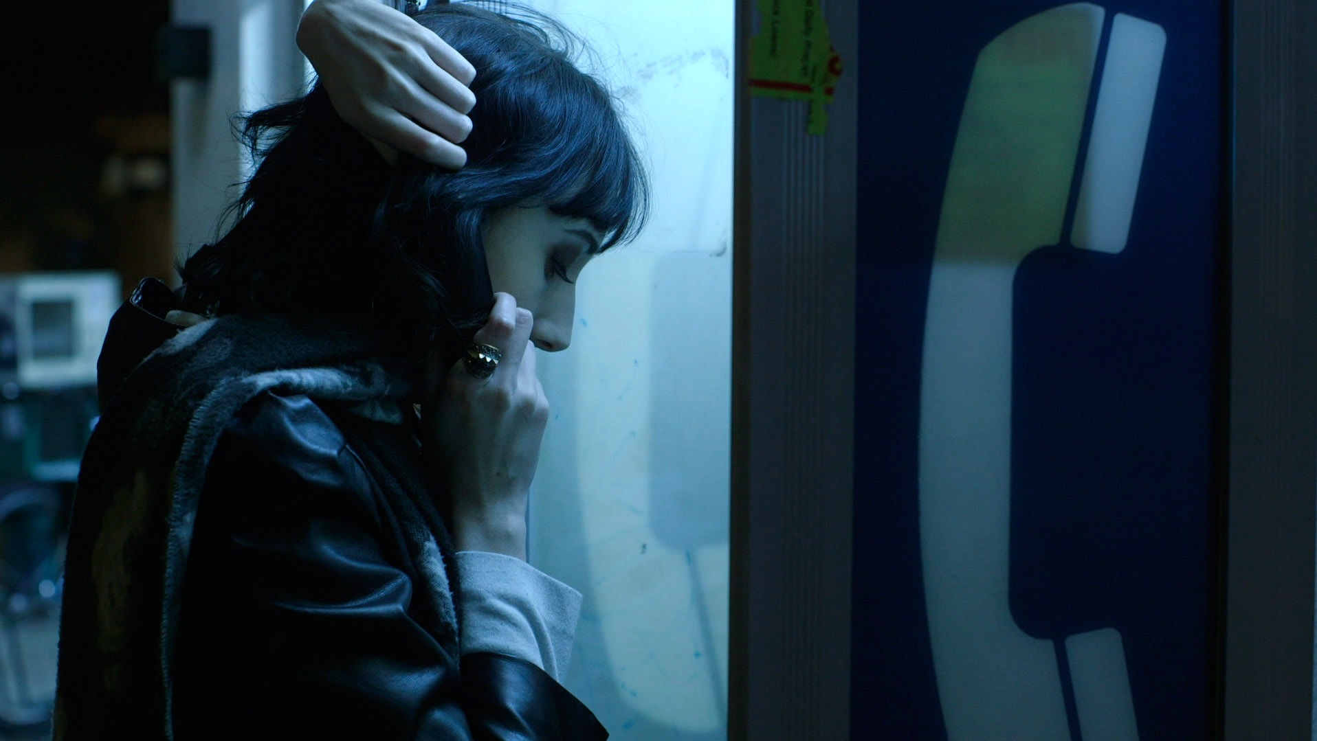

Well....I think that most of the discussion surrounding the C300 post launch, pre-delivery focused not on the lack of noise, but on it's "quality". DSLR footage up to that time had shown a lot of chunky patterned noise starting around 2500 ISO and the C300 is simply superior not because of a lack of noise, but that the noise looks organic, is finer and is largely reminiscent of film grain most of the time. Additionally, most of the early shooters were specifically shooting in C-log "locked" mode, which has no sharpening. In this preset mode the camera will exhibit the finest, least present noise, but frankly you're really looking at 1-2 stops loss of speed when shooting in this mode due to its log type gamma and highlight protection. Canon Log -- in all light levels -- compared to the other presets gives a much silkier noise free image largely due to the lack of sharpening. (this camera is so detailed that I'm not sure why any of the presets include higher sharpening levels, but they do).
My vimeo postings from several months ago, regarding shooting by "moonlight" show that this camera is capable of impressive results under the lowest of light levels. I made a simple preset based on one of the normal settings with sharpening turned off and a small level of noise reduction (you should try it...takes about 3 minutes to learn how to set one up and then selecting it is as easy as selecting one of the factory presets.) Below I've attached three stills from a section shot at 6400 to 12,800. These have no additional noise reduction, but have been heavily graded (which should have increased the noise somewhat). I'm having a hard time finding anything objectionable about the noise in these, and certainly the detail we see in the hair and skin is something you'll never see even in good light from the 5dmarkIII.
C300 low light performance not quite as super as expected-picture-698.jpg   C300 low light performance not quite as super as expected-picture-697.jpg
Barry Goyette is offline   Reply With Quote

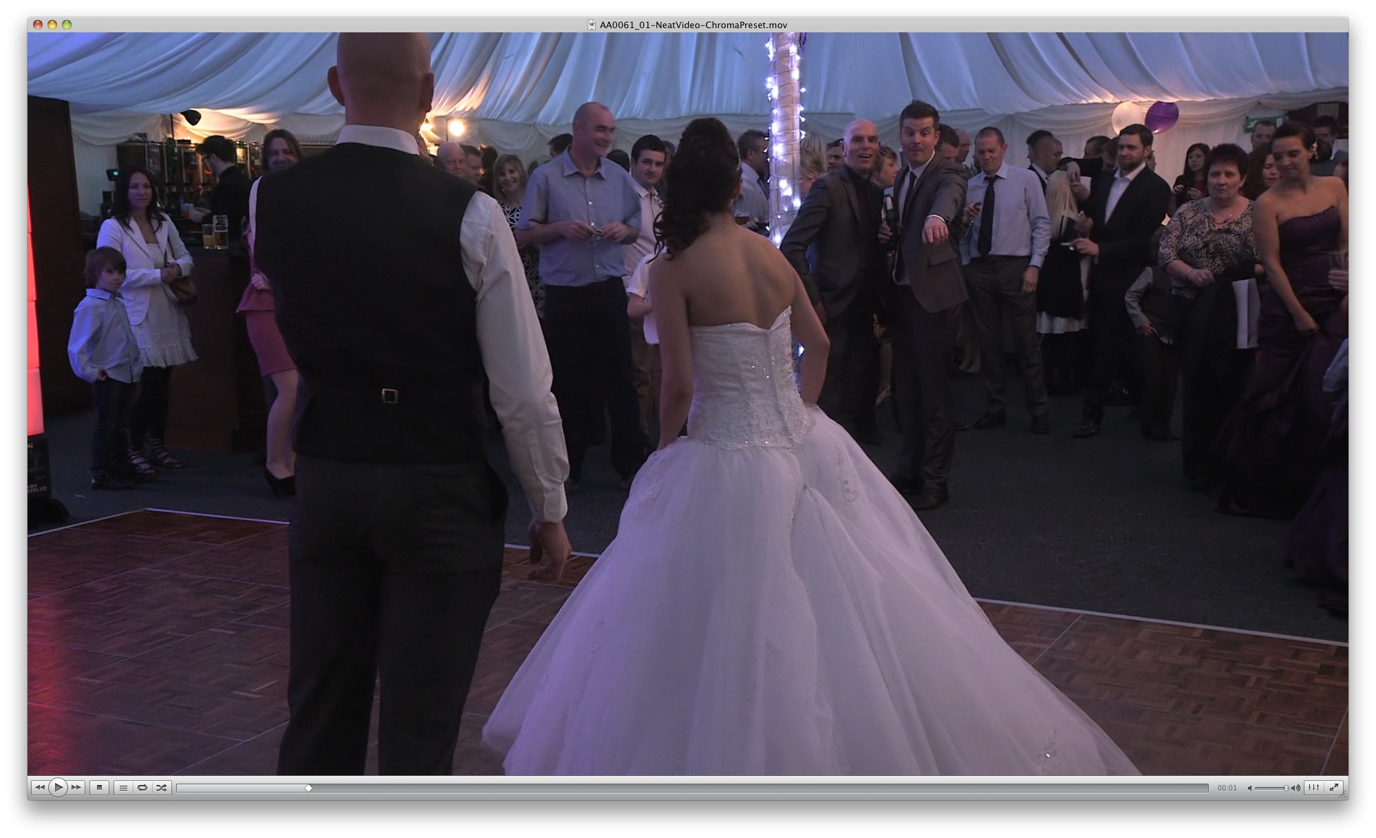

Here is a frame grab that shows what I am talking about. The noise on the bride's dress, back & shoulders, the groom's shirt & in fact any light areas in the image make this clip unusable as is. I haven't yet tried de-noising but don't hold out much hope of a good result.

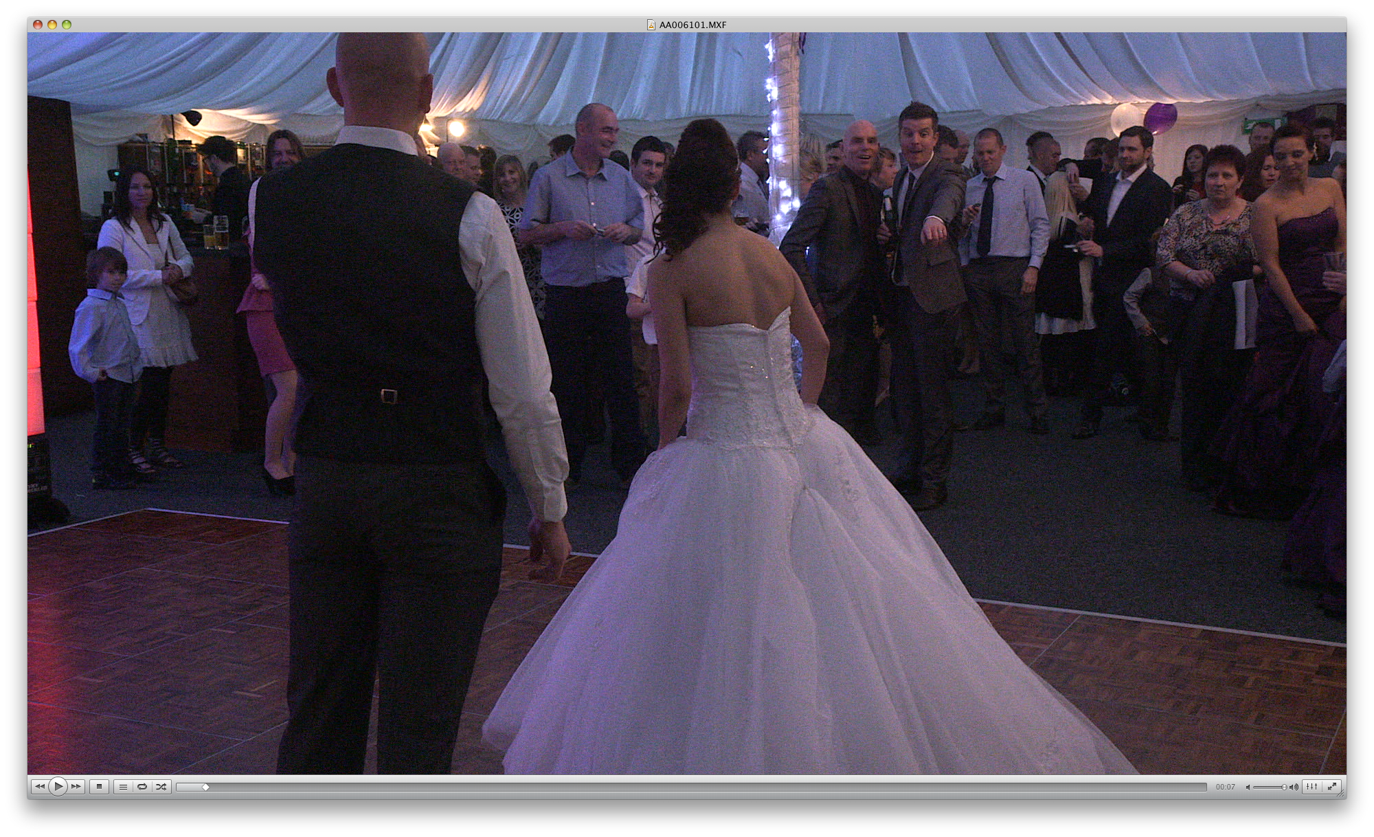

We are delivering on Blu-ray which is going to be viewed on a 40-50" HDTV close up (we generally have small living rooms here in the UK) so the fact that the bride's beautiful white dress is transformed into a shimmering mass of colour for us rules out using that clip as is. Our usual trick when we have managed to screw up something (generally exposure) is to render it in monochrome but I have just run a portion of the clip through the latest version of NeatVideo & I am officially impressed. It has not only completely removed all the chroma noise but hardly softened the image at all. It's some time since I used NeatVideo & this version is now much faster as it is can be configured to use all 8 CPUs in my Mac Pro plus CUDA acceleration with the the GTX285 graphics card.
Here is a screen grab of almost the same frame after the clip had been processed by NeatVideo in FCP7.
C300 low light performance not quite as super as expected-c300-chroma-neatvideo.jpg

Hi Nigel.
wow...that's looks pretty bad. not at all what I'm seeing from my camera here. This is on par with the noise I see from the camera at ISO 20,000, not 6400. (and just so we're clear, this image hasn't been adjusted, correct...just straight out of the camere?)
I think though, that my suspicions were correct, in that the sharpening, and perhaps mid-tone lifting of the preset you are using are the primary cause of all this noise.
Glad to see that the neat image denoiser works for you. From my little tests, i'm amazed at how much detail is hiding behind the noise in some of the high iso stuff I've shot, but I'd recommend building a preset as your best option for getting the most out of this camera.
