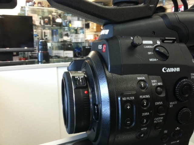

Canon C300 + 40mm pancake Mfr# 6310B002
Auto focus doesn't work... yet?

Hi Philip,
Great photo!
Looks like a fancy lens cap!
Bit fiddly to focus manually on a C300 so autofocus would be a great addition to the firmware wish list.
Can't be that difficult?

I have to admit, the pancake on the C300 made me giggle. :)

We won't ever see proper auto-focus on the C300 as it doesn't have the necessary hardware like the XF105/305 or even the T4i/650D for using the new STM lenses.

I agree with what you say " We won't ever see proper auto-focus on the C300 as it doesn't have the necessary hardware like the XF105/305 or even the T4i/650D for using the new STM lenses"
The hardware you refer to is presumably the sensor?
The actual mechanical focus adjustment is achieved within the lens either with USM ( UltraSonic Motor ) or the new STM.(Stepping Motor Technology)
The T4i/650D has the hybrid CMOS sensor that has a phase detect capabilities built on the image sensor itself to enable it to constantly auto focus.
Now I'm not clever enough to really understand how that all works and all I would ever want would be to to electronically spot check the focus. Just like I do with my Canon 7D.
So could a firmware update enable the C300 to utilise the contrast detection autofocus method?
This is achieved by measuring contrast within a sensor field, through the lens. This method of autofocus is implemented in software.

I suspect that the C300 doesn't even have the hardware necessary to talk control the focus motor within the lens.

The C300 is able to focus a lens through the wireless controller or a Lanc controller so that end of the equation is there.
All it needs now is the firmware to be tweaked to enable the sensor to be used to measure focus . . . or not.
This is a question for someone like Alan Roberts.

Then how is it the WFT can pull focus?

Of course you are absolutely correct I had forgotten that I had actually read a review of the WFT-E6 used on the C300 describing the ability to remote focus.
