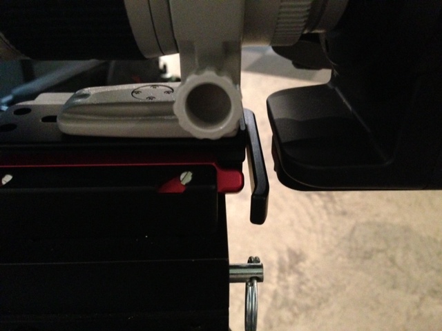

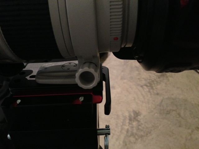

Work around mentioned above for using the Kessler Kwik Release with the C300/70-200 f/2.8 Combo
Lens locked down, camera in normal position, on left. Rotate camera/lens to get the camera body out of the way and give clearance to lock/unlock the large lever.
If you were to use the RRS B2-LR2 II clamp instead the photos are those that you see in my post #9 above. The RRS lever is smaller on the back end. Depending upon how the lens foot is placed in the clamp it can be a bit snug to unlock. It works but if the lens foot is too far forward one would have to rotate the setup all the same.
C300 & Canon EF 70-200mm f/2.8 L IS USM - Lens Support?-photo01.jpg   C300 & Canon EF 70-200mm f/2.8 L IS USM - Lens Support?-photo02.jpg
