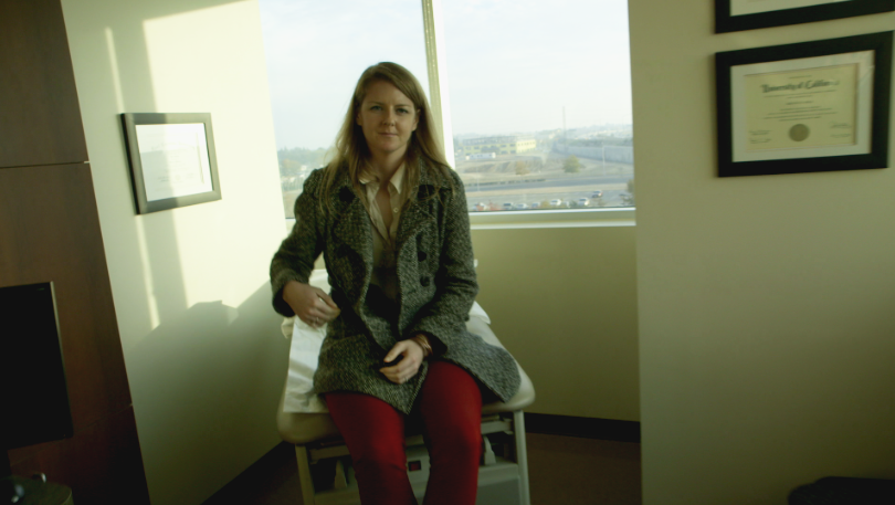

Yesterday I was scouting an office location for a shoot today, and the room we're shooting in largely illuminated by light filtering through those 90's era greenish reflective glass panels that we see on so many office buildings. Visually the light coming through the windows was a yellow green hue.
The problem is not that the camera totally misread the color as being in the 7800-8700k range... I'm used to that with this camera. It consistently reads my kino-flos at 6800 and produces a yellow result, so we manually set the camera to 5800 for best results.

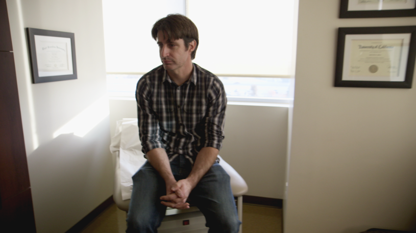

The issue is this...in hunting around for a correct white balance I hit on 6500k first using the "push wb" feature. This looked good in camera, but as I shoot in log...it's always hard to tell. Later I dialed in 6500k using the kelvin set function and shot another test clip. When I brought both clips into xf utility, and checked metadata...they have identical WB settings except for the method of achieving white balance (push versus kelvin input), but the color response couldn't be more different...
(also amazing what it did to the models pants and hair... :-)

Dialing in Kelvin will not take out any green hue from windows that have ND or flourescent fixtures. If you want to take out the green in camera you have to white balance the camera. Sometimes just tilting the white card in different direction (toward the green source) can dramatically change the white balance.
Same can be said of outside sources, shade, full sun.

So are you saying that the camera, in addition to setting the kelvin at a measured value (when using push white balance), is also applying a tint to correct beyond the base kelvin temperature? (This is how still cameras work, but I assumed that video didn't as you have no control over tint beyond kelvin -- other than going deeper into the camera setup via color matrix etc). If so...I've learned something.

A camera that is white balanced against a white card makes adjustments to the red, green and blue channels at the proc amp to try to bring all three signals up to equal balance, thereby creating white (colour additive model: equal parts of red, green and blue = white)
A camera that is set to a "known" colour temperature is making adjustments to the proc amps based on assumptions around spectography of the light and is best used for "normal" light: tungsten, HMI, daylight and NOT heavily "polluted" spectographic sources like sodium vapour/halide, LED and fluorescent which contain peaks in the spectrum that are not linear like other sources.
Colour temperature is not the EXCLUSIVE representation of colour spectrum. It is far more a representation of where on the Red/Blue continuum the light lies.
