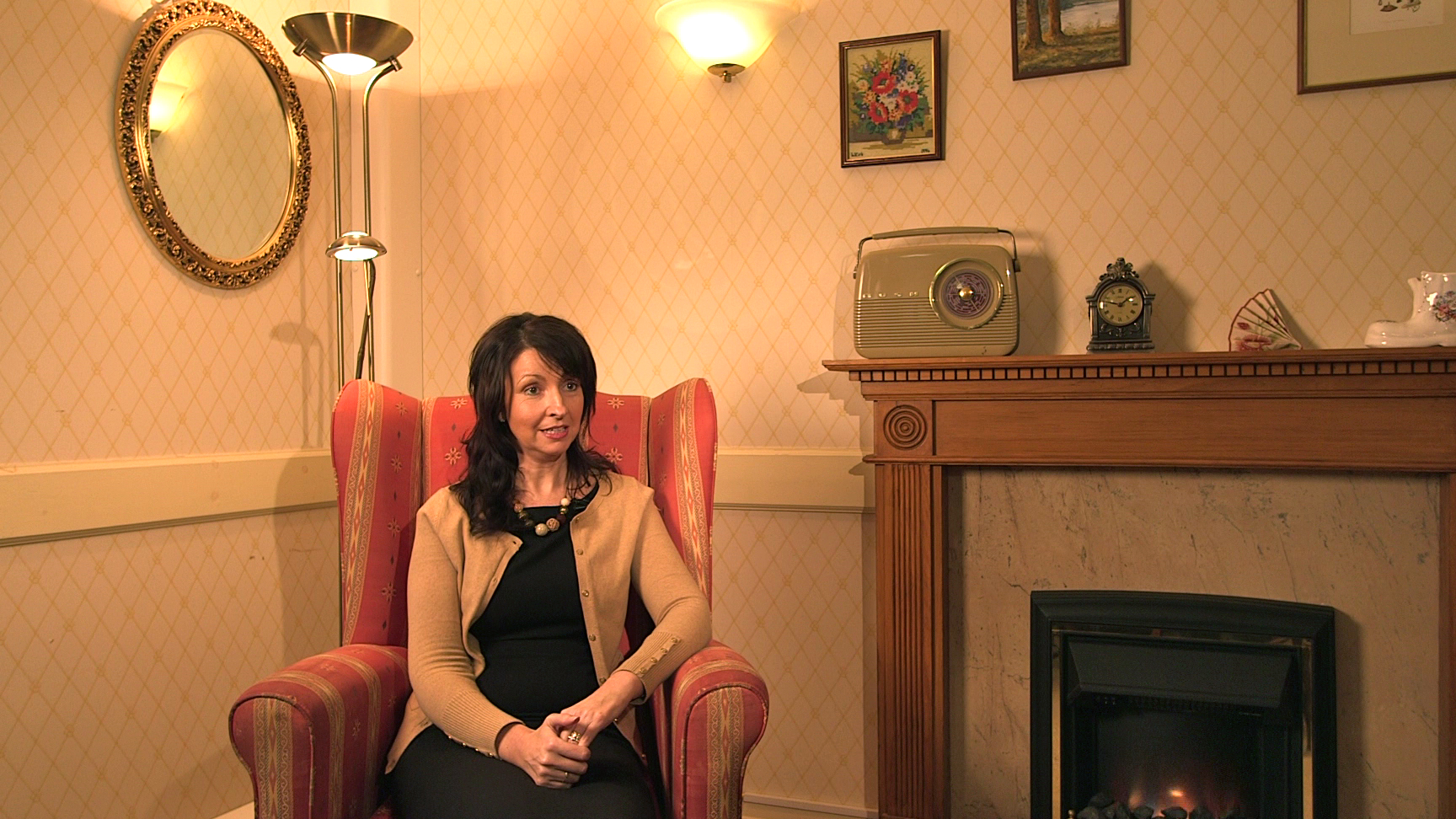

Attached is a screengrab from a shoot with a C100 and EF-S 10-22mm .
Somewhere along the route via VLC and iphoto it has been cropped slightly. I don't have time to work out why.
So it is not as helpful as it could be.
Even so I am posting in case it is of any interest.
I think the lens was as wide as it would go. I may have zoomed in very slightly for framing.

Re: Canon EF-S 10-22mm on C300?
Thanks Richard
