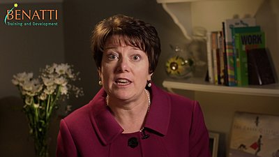

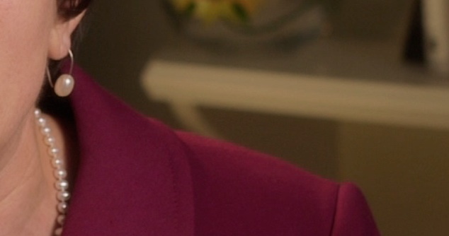

As with other cameras I've owned, I've noticed that (especially) red edges can sometimes be jagged (see the two images attached -- you can see it just a little in the shoulders). Any thoughts on avoiding that either in the filming or editing stages?
Filmed at 1080/30 1/60 (180º) shutter. 320 ISO. f/3.5 with a Canon 50mm f/1.2 lens.
Lit with LED 1x1 and reflector for fill; litepanels as backlight and background.
Thank you!

All part and parcel of a 4:2:0 colour space - strong, intense colours don't have much luminance detail, and so they're defined mostly by chrominance, which is (roughly speaking) a quarter of the resolution of the luminance information.
One can try reducing the chrominance a notch or two in-camera, transcoding the AVCHD to ProRes and performing a 'chrominance reconstruction' filter (which does a little fancy blur on the chroma signal) before boosting the chroma level back up (to avoid clipping the chroma - this is more for stage-lit productions, though).
Or consider shooting onto a Ninja using the 4:2:2 HDMI output. 4:2:2's chroma is at half the resolution of the tonal luminance image, which will improve the edges.
