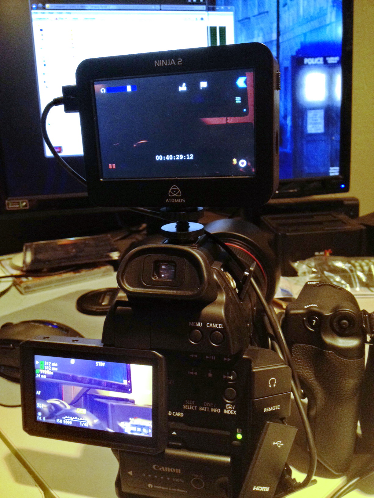

Here is how bad it is. I have done a dozen other tests and it just plain is too dark. In images that are bright it even appears the contrast is too high and the image posterizes. Hope I can get some help. I have a shoot mid week and this was the last one I could find in stock anywhere. Ugh!
There's definitely something not right about your Ninja. Here is a photo of mine:
http://www.pixol.co/wp-content/uploa..._ninja2-01.jpg
As you can see the ninja screen is bright snd clear. Sorry you can't see the C100 LCD but I can tell you there isn't all that much difference.
Silly question but have you tried a different hdmi cable?
It cannot be the HDMI cable as I have tested the caddies from both my Samurai and my Ninja2 in both. In other words, footage I shot last week at a dance recital on my Samurai, looks way too dark on the Ninja2. So to be clear, it affects prerecorded images also, which leads me to believe that it is something to do with the screen itself, or possibly the image processor just before the screen. I believe the footage is fine....it's simply the display. Either way it is un acceptable. I need to get another one and try it.
I will keep you posted. I did a hardware reset and flashed back to the previous bios and the problem still exists. Again, this is not a C100 issue at all since I have rigged up a Frankenstein rig with HDMI to SDI converter and the footage out of the C100 looks fine on the Samurai.
Thanks. What a frustrating weekend. Was so excited to get this on Friday!

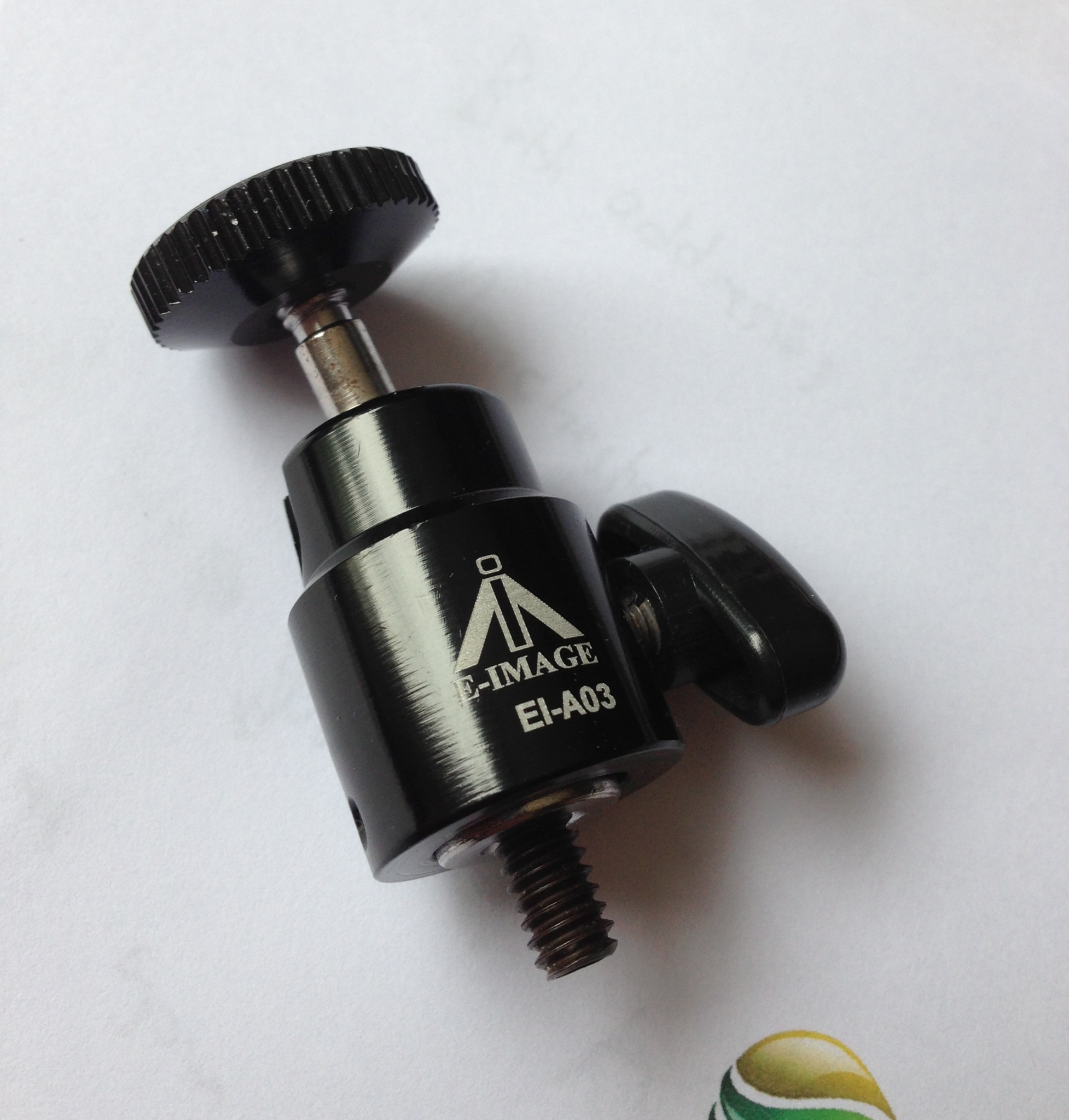

Marty,
The mount I linked you to does allow you to use the 1/4" hole, you just have to remove the hot shoe fitting by screwing it off.
The caddies are very tight to remove at first but become easier with use. I'm glad to hear you got yours replaced quickly.
Happy shooting.
Drew.
