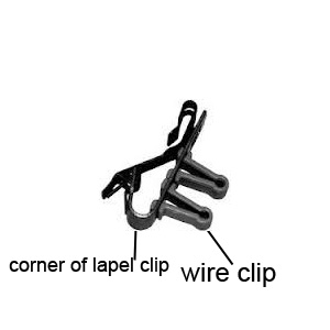

Old May 29th, 2013, 06:02 AM   #20
Join Date: Oct 2010
Location: NY, NY USA
Posts: 527
Re: C100 audio
I am not sure if I understand. Sorry this is a second lav clip I've seen in my life. See attached image. Is this what you mean by wire clip and "corner" of the lapel clip?
Kathy Smith is offline   Reply With Quote
Old May 29th, 2013, 06:22 AM   #21
Location: Berkshire, UK
Posts: 1,562
Re: C100 audio
Very similar to the video I posted on the previous page. :-D
First loop (up) goes into the space at the end of the clip you use to attach the mic. It then loops down and clips into the bit at the other side, so the cable hangs DOWN (which makes it neater to thread).
My rushed video failed to show me twisting the mic around in the clip in order to make the up-loop lay flat. That's the trick - twist the wire to make the loops lay flat both on the up loop and the down loop. Ensure that, when you clip the whole thing to a lapel or shirt, that the cable naturally wants to hug the cloth and point the cable in the right direction. It's all in the twist.
EX1 x2, C100 --> FCPX & PPro6
Old May 29th, 2013, 06:59 AM   #22
Join Date: Jan 2003
Posts: 6,609
Re: C100 audio
Kathy,
the "wire clip" in your photo is the "mic clip". That's where you put the microphone by removing both of the clips (only need one) push that over the cable by the mic capsule, squeeze it together and put back into the lapel clip. Now the cable is hanging down so take it UP and open the back of the clip by squeezing it like you were putting it on someone. Now the cable is looped from the mic into the corner of the lapel clip. Now take the cable and slip it into the loop of metal on the back of the lapel clip going in a downward direction. It looks like an "S" laying on it's side.
As Matt stated it's best to twist the cable a bit just to make sure it lays flat and doesn't want to "bunch" up.
Don
