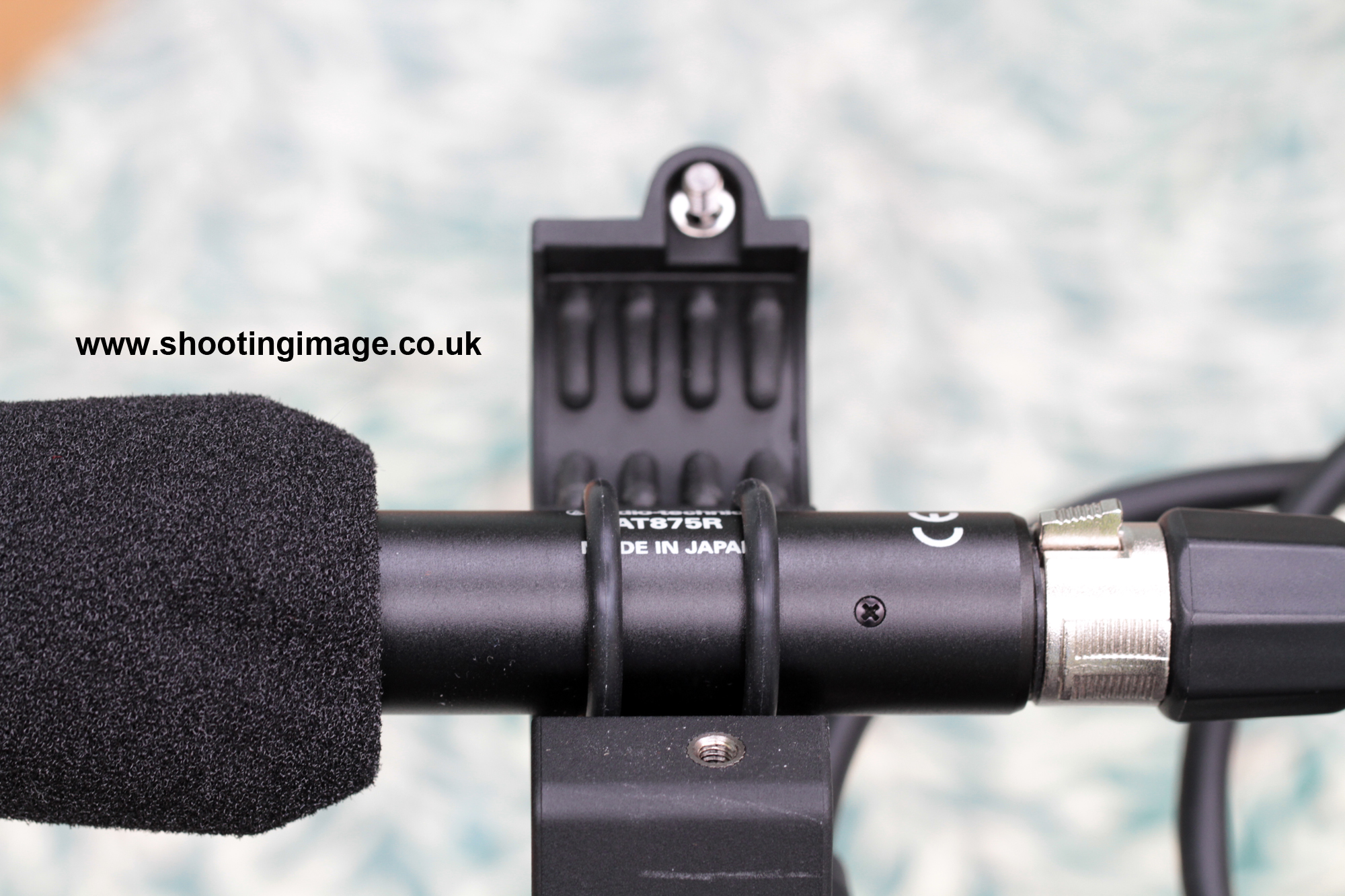

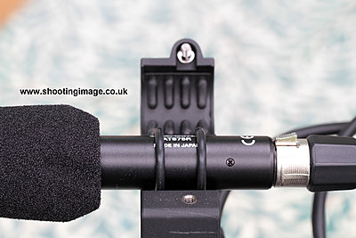

I just use neoprene 'O' rings - you can get something suitable from DIY stores. Very cheap! They are about 2-3mm thick and about 18-20mm diameter. Just pick a size that needs to slightly stretch to roll onto the mics body. Once you've slipped a couple of them over the mic tube and got them positioned where you want them just clamp up the mic mount and away you go!
Actually, come to think of it, my AT875R short shotgun mic even came with some suitable 'O' rings.
EDIT: Adding a quick pic to show you what I mean.
