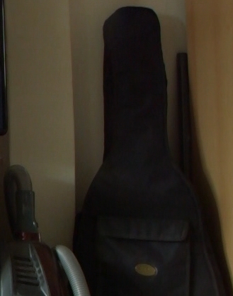

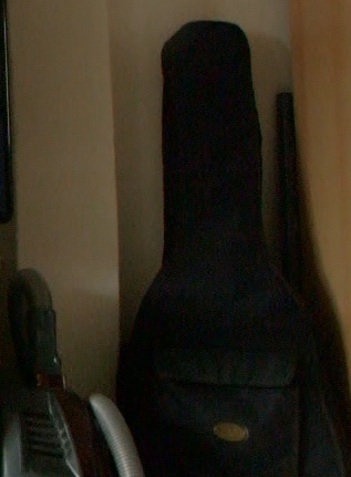

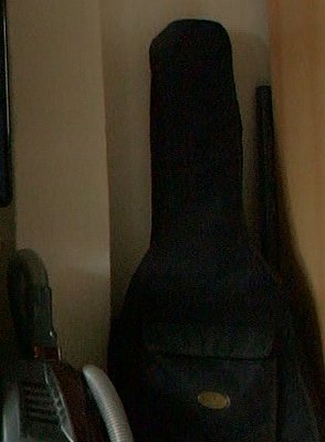

WDR has a lot of noise at 50i and 4000iso, look at crop pictures from wdr vs. cine1 testing (tiff + jpeg versions). I used wdr only to iso1250 (or 2000).
Sharpening of wdr gamma is from the CP?
C100: Wide DR: Always amazed at it's ability-060-wdr-4000iso-50i-test-noise-crop.jpg   C100: Wide DR: Always amazed at it's ability-061-cine1-4000iso-50i-test-noise-crop.jpg

Yes, so you have to 'write-unprotect' it, lower the sharpening, resave it, reapply write protect (if you wish).
But your example is another lovely display of things to watch out for. Around 20-30 IRE? Looks a bit less...

I am editing now, so I don't have time to look to another project to WF for IRE level, but it was a dark afternoon (and small windows at a room .-) ), some correct scene for iso4000 testing (50i).
My WDR CP is built from a clear preset, so it has sharpness -3, coring 0, no noise reduction, it's the same sharpnees setting as has the second cine1 CP.
For cine1 I use normal4 color matrix and I change a color saturation level (color gain). It has better colors for me.
