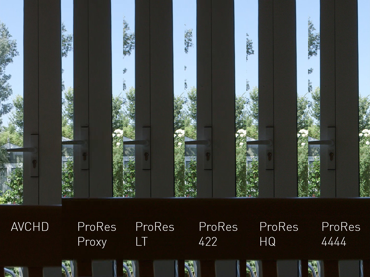

There are times when the AVCHD is just fine (80%?), there are times when the AVCHD can look a little better than the Ninja at ProRes422 - rare occasions due to challenging circumstances - and there are situations that can kill AVCHD.
I've joked in my C100 workshop that the worse situation for AVCHD and where a Ninja would be obligatory would be filming the Ferrari F1 team in the pits: lots of red, lots of detail, lots of motion. One chap said that it's even worse at Sikh weddings - lots of red fabric in action! Definitely a Ninja job.
Here's a sequence showing how AVCHD can't really cope with high motion with high detail.
AVCHD Killed by a tree
You can see the LongGOP IPPB sequence really clearly.
So, you get a Ninja - but... BUT! Be careful. The AVCHD recording includes a soupçon of noise reduction, but the ProRes 422 codec can bog down on the noise, especially in the 25-35 IRE area:
http://www.mdma.tv/c100/noiseandprores.jpg
In low-key shots (lots of murky shadow details) you need to use the ProResHQ setting to provide enough bandwidth to capture the naturally 'diffusion dithered 8 bit' C100 image.
Hence this dichotomy of 'yes you need a Ninja' and 'no you don't need a Ninja' - you sometimes need a Ninja but you might go a whole year without using it in anger. Depends on what you shoot and how.

Matt, I think, nailed it with the last image in his post. But for me and some others who are shooting for broadcast the Ninja is even more important in order to get a broadcast-ready bit rate. To be honest, if I didn't need to shoot for TV, I might have held off the Ninja 2 purchase. But it was kind of a necessity.
I can tell you that filming in darker situations with higher ISOs, the Ninja Pro Res 422 definitely looks better than the AVCHD.
