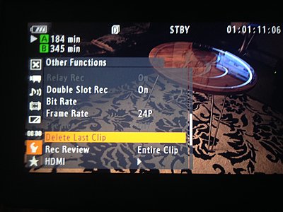

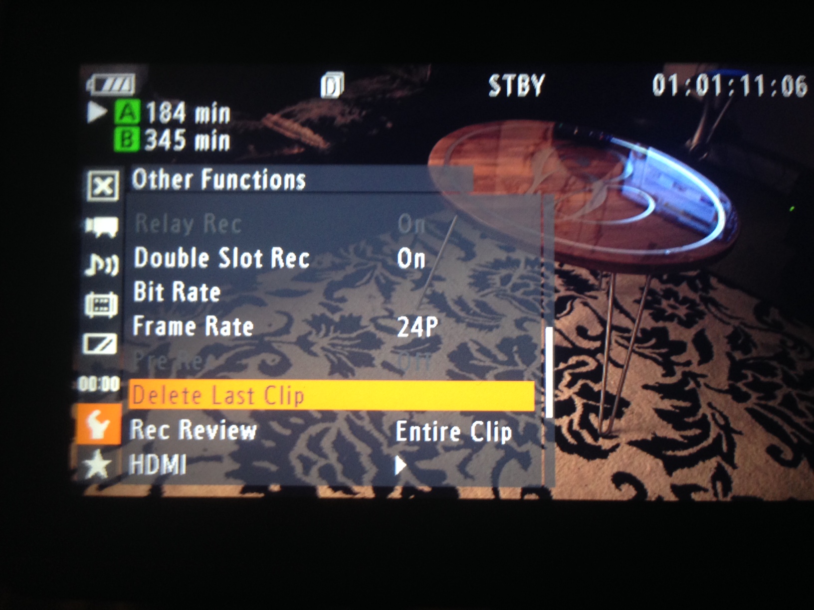

Hi,
I'm attempting to "delete last clip" in the menu > other functions on my C100, however the option is grayed out.
I have recorded a clip, can see it on my preview, but cannot delete it.
Stefan, new C100 owner

It won't do it when you're in double slot recording mode, and it won't work if you've turned the camera off since the last clip was recorded.
Just tried it and yup, can't if you double dip it. Arse biscuits! Not giving up the double slot record just to delete the last clip, ill let our rough cut editor worry about the junk :)
