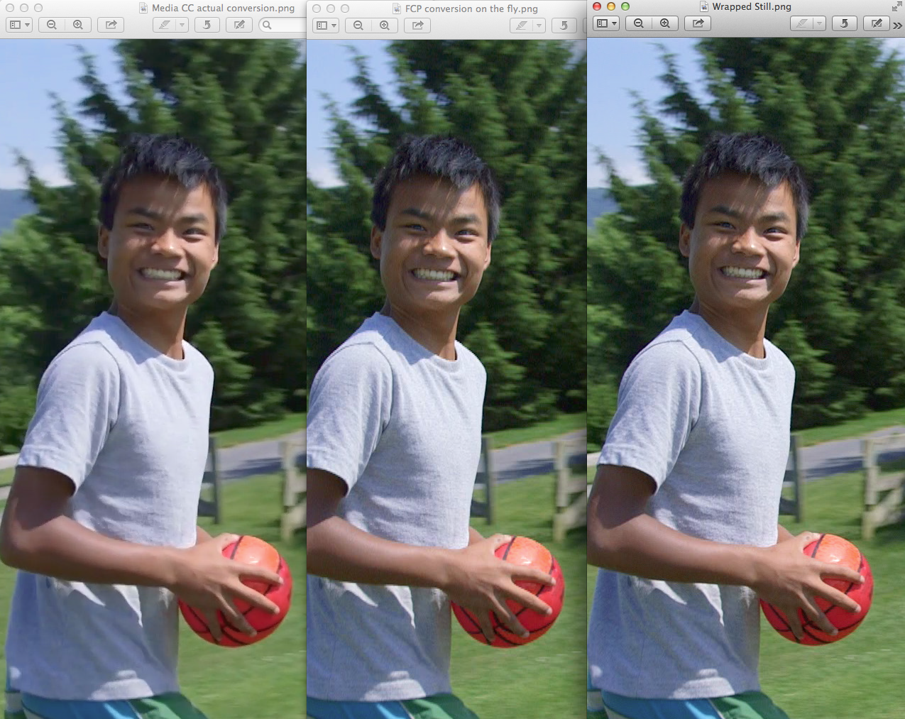

Technically I don't actually know, but it's interesting that the actual conversion sucks more than the on the fly conversion. And that may be b/c of the settings. Here's a screenshot where you can see that each one is just a little bit different. Left to right are Media Encoder CC conversion, FCP on the fly conform to converted clips settings (1080p, 23.97) and finally the original clip dropped into FCP at 1080i, 29.97.
The ball does seem to have something say, doesn't it? Sure looks like half a frame to me. Well, I did say quick. And dirty...

That's because Media Encoder also does not remove 3:2 pulldown. Anything that you use that just renders out 24p from what you give it, without giving you explicit options about the pulldown, is simply doing a deinterlace and throwing out frames.
