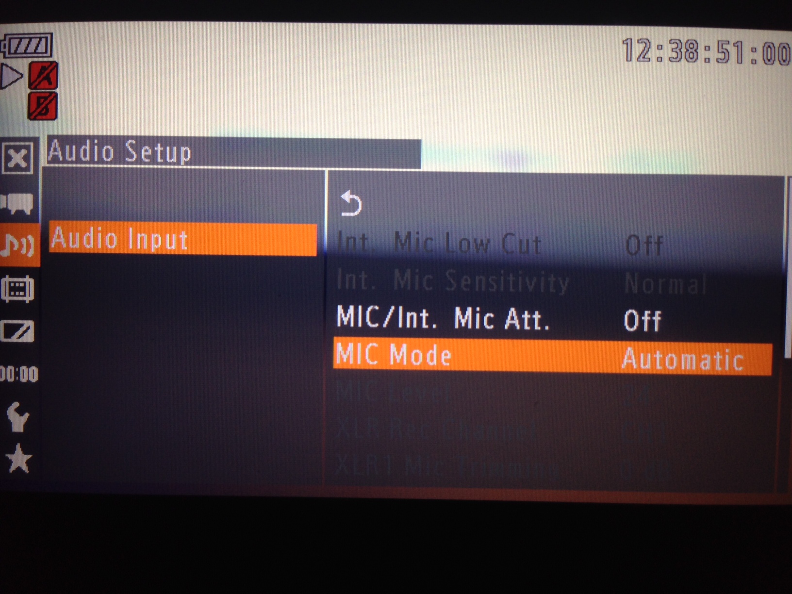

Hi,
The MIC Mode is set to Automatic, and the MIC/Int. Mic Att. is Off.
This works fine in normal settings but when DJ announces grand entrances for wedding, or he is playing music for dancing, the sound often becomes terrible.
I can see the audio meter in the bottom of my LCD show that it in the "red" when this happens.
However when I set MIC to Manual, I find I have to constantly change the settings being afraid it is too low, then too high.
Any suggestions ?

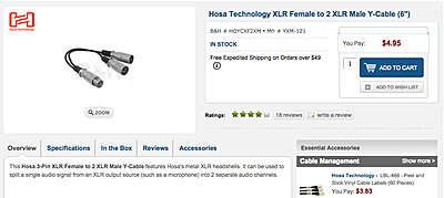

This is the Y cable I found online, http://www.bhphotovideo.com/c/product/252312-REG/Hosa_Technology_YXM_121_XLR_Female_to_2.html
If I use this Y cable, how could I adjust the gain on one channel to record louder then channel two, for instance?

You'd just set the input separately for each channel - for example, if you set one channel to 5, you could set the other to 4. You could monitor the signal and just make sure that the peaks on one channel are 6 to 12 lower than the other.
You just can't do this if you have one mic plugged in and set the audio to have Channel 1 record to both 1 and 2, as Matt was talking about.
Did you ever check to see that you had the Limiter turned on in the menu settings as I suggested a few messages back? It's supposed to be there to take care of blown out audio like this, and I keep it turned on all the time. However, given my recording situations I don't know if I've ever had a situation where it's been needed or not.

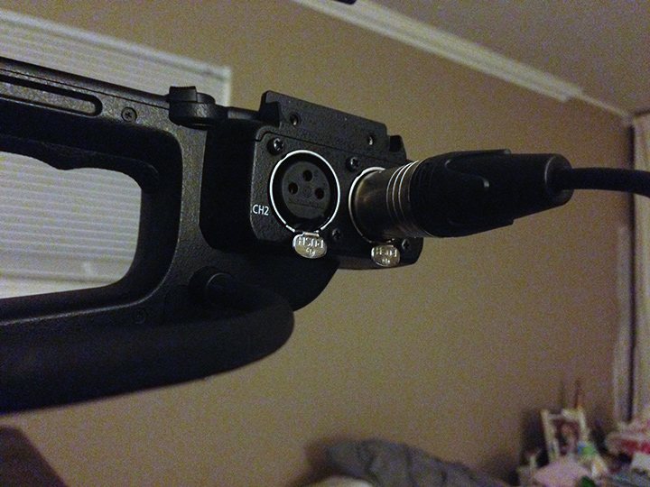

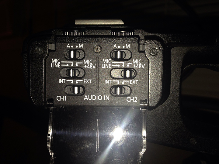

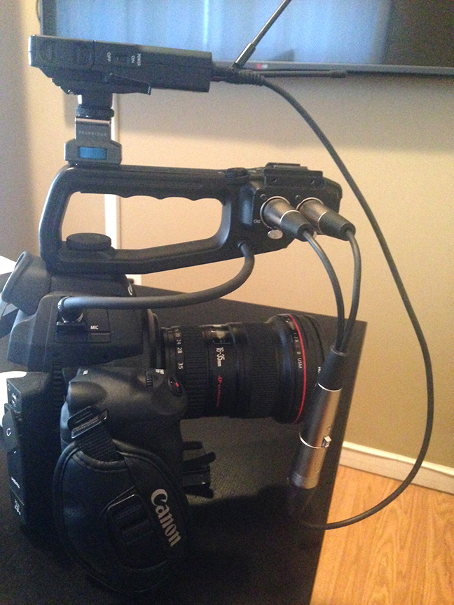

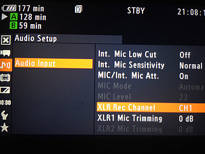

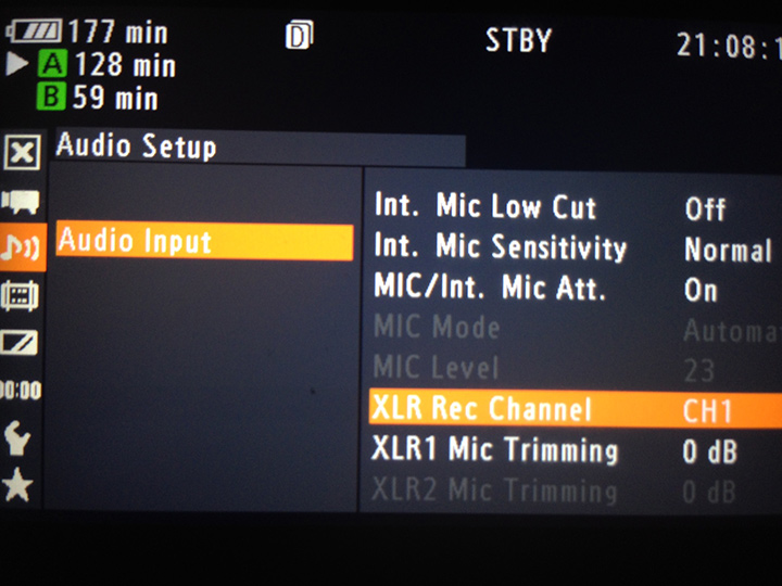

Ok, still can't seem to figure this out. I have my built-in mic and lavalier both recording but the built-in mic only records mono to the left audio track while the lav records mono to the right track.
Ideally I would like to record from the lav and built-in mic at the same time, to both tracks. I Matt Davis mentioned a mixer but I don't know anything about that :(
I have tried with the single XLR into one channel and also with a XLR splitter into both channels, with no difference in results.
I'm attaching some reference pics for setup help / advice both with the cables and internal C100 settings.
Thank you!
Stefan Gill is offline   Reply With Quote

Originally Posted by Stefan Gill View Post
...Ideally I would like to record from the lav and built-in mic at the same time, to both tracks. I Matt Davis mentioned a mixer but I don't know anything about that :(
Your camcorder is not going to give you a mix of two mics. Instead, as you've found out, you'll get two channels of mono, one for each mic.
This is by design, since mixing is typically deferred to post, where you can take more time with adjusting levels as needed. If your camcorder did mix, that's the mix you'd be stuck with, for good or ill. This is bad for the one-person-band; defer as many creative decisions to post as possible.
Matt's right, too; you can add a mixer to the setup. More wires, more batteries, more dials and meters, but yes, you can mix two microphones to the two recording channels on your camcorder.
But I'd suggest getting familiar with the audio channel tools of your editing software - that's best for many circumstances, and may be best for your wedding shoots.
