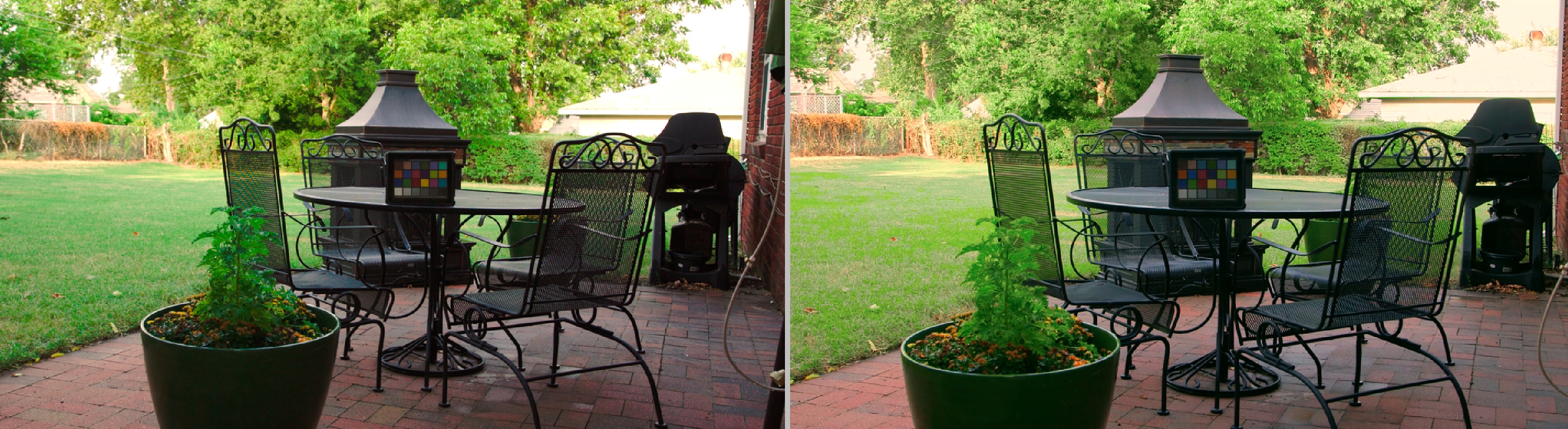

Hey guys,
I know this has been covered in previous post, but has anyone tried matching both cameras using Davinci Resolve and the Auto Color Match feature? I decided to try it today due to I'm shooting my nephew's wedding later this month. Please keep on mind I'm no expert colorist, I'm just a novice. I've been playing around with Resolve for the last couple of months.
The setup I used was the 5DM3 has Magic Lantern 123 with the Technicolor profile. I used Wide DR on the C100. I used he 24-105mm F4 on both cameras and both were set for 5500K WB.
As for the X-Rite chart I found a downloadable sample online, so I downloaded it, saved it to my iPad for testing. I didn't want to buy one until I was able to test to see if it would work. going forward I think I will purchase the Passport tomorrow.
I've included a couple of samples and feel free to comment. As I mentioned above I'm no expert, just beginning to be a novice....
David

I'm facing the same issue, just got a C100 and have a 5D3. I'm guessing the 5D3 is the photo on the left?
I'm no expert either, but looks good enough for jazz.

You're right. 5DM3 is on the left.
