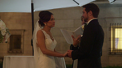

Old October 8th, 2014, 10:15 PM   #7
Join Date: Aug 2010
Location: Beverly, MA
Posts: 512
Re: Canon C100 Shutter Speed 30?
Originally Posted by Kevin Lewis View Post
It wont be to much motion involved. Its for the ceremony portion of a wedding. I will be using the 24-105 which only has 4.0.
I am also a 30p 1/60 guy, but I won't hesitate to turn down the speed to 1/30 in really dark settings where there's no fast movement.
I was at a really dark wedding (at night in the rain with basically no lights on (and umbrellas shielding away any light there was) in Boston. I was SO impressed with how the C100 could see in the dark.
This image (and believe me, you could barely see them in person) is 30p, 1/30, ISO 12,800 (no grading). Sure, it's not the sharpest, most vibrant footage, but, given how it looked in person, I'm impressed. (Fortunately, the rest of the day was in nice, slightly cloudy light outdoors and elegant interiors. Just the ceremony was a beast!)
