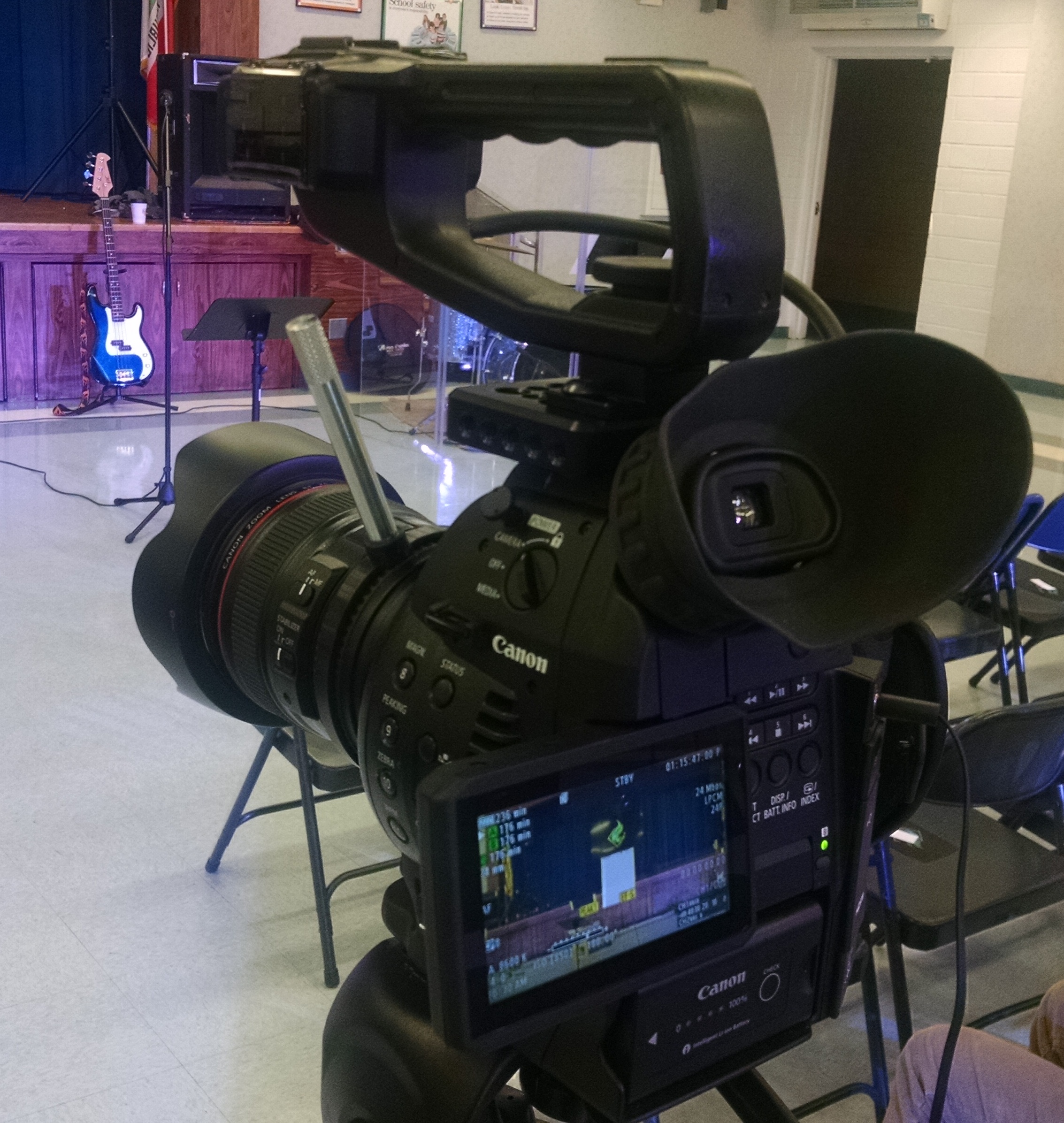

This is the best solution and it's really inexpensive (only $10-$16 on ebay), Here's a picture of my C100 with the device! I use it with my Canon 24-105 L lens. Works Perfect! Nice Smooth Zoom! (Link below shows product on ebay).
Follow Focus Alternative for All DSLR Camera'S | eBay

Originally Posted by Troy Moss View Post
Jody,
Thanks for the links/photo.
Is it really that much smoother than zooming manually? I guess for the price there's no harm in trying it out!

Re: Power zoom EF lenses
Yes, it's much smoother! Yes, you definitely can't go wrong for the price. I've recommended this (and similar products) to several other shooters and they continually thank me. It really works. Several other models and variations of this on eBay and the internet, just do a search!
