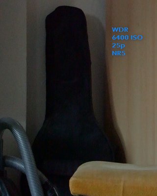

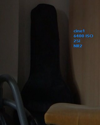

Re: ? about C Log
cine1 vs wdr gamma
? about C Log-109e2_wdr_iso6400_25p_crop.tif   ? about C Log-109f_cine1_iso6400_25i_crop.tif

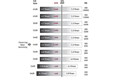

850 or above is the recommendation. The same applies for WideDR.
Go below that and you will notice clipping in your image. We prefer to put on an ND filter and then up the ISO to compensate than go below 850.
See this image from canon

Kevin, the image Danny posts kind of says it all.
That image, and much more information, is included in a series of White Papers Canon has released on the Cinema EOS system. You can find them on Canon's home page.
Canon Log has been designed to deliver 12 stops. It maintains the same dynamic range over all the ISOs, but the point where 18% gray lands may shift.
The reason for the ISO850 recommendation, is because it is the lowest ISO (least noise) that still provides maximum highlight protection.
You can get a cleaner 12DR stop image by lowering your ISO, but you will lose some highlight protection/range. Still, this might be exactly what you need in some scenarios.
