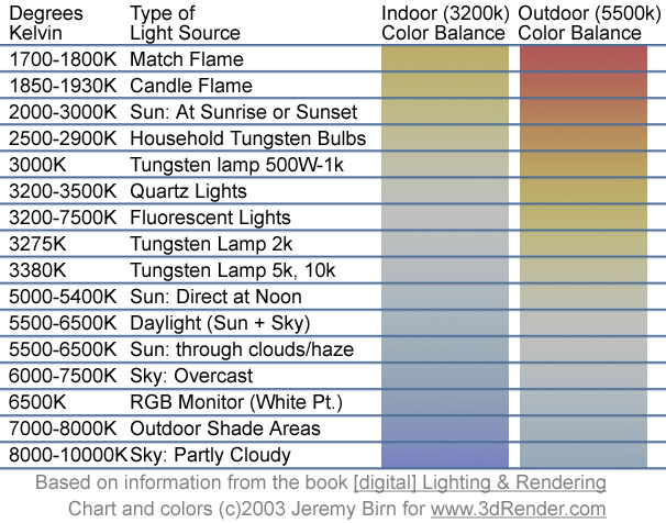

There's is no time to set white balance with a card when you're in a run/gun situation. If you have time ask someone to hold the card otherwise learn your kelvin settings which is pretty straight forward. For wedding receptions with LED/Florescent lights don't under estimate the power of auto white balance, auto sometimes does an amazing job at eliminating the green cast from these light sources for everything else there is kelvin.
Alex Harper is offline   Reply With Quote

Nope auto only works sometimes to eliminate the green cast from LED/Florescent, use with caution but don't rule it out. Mixed lighting 3900-4500K work well. The card will always be the best.
