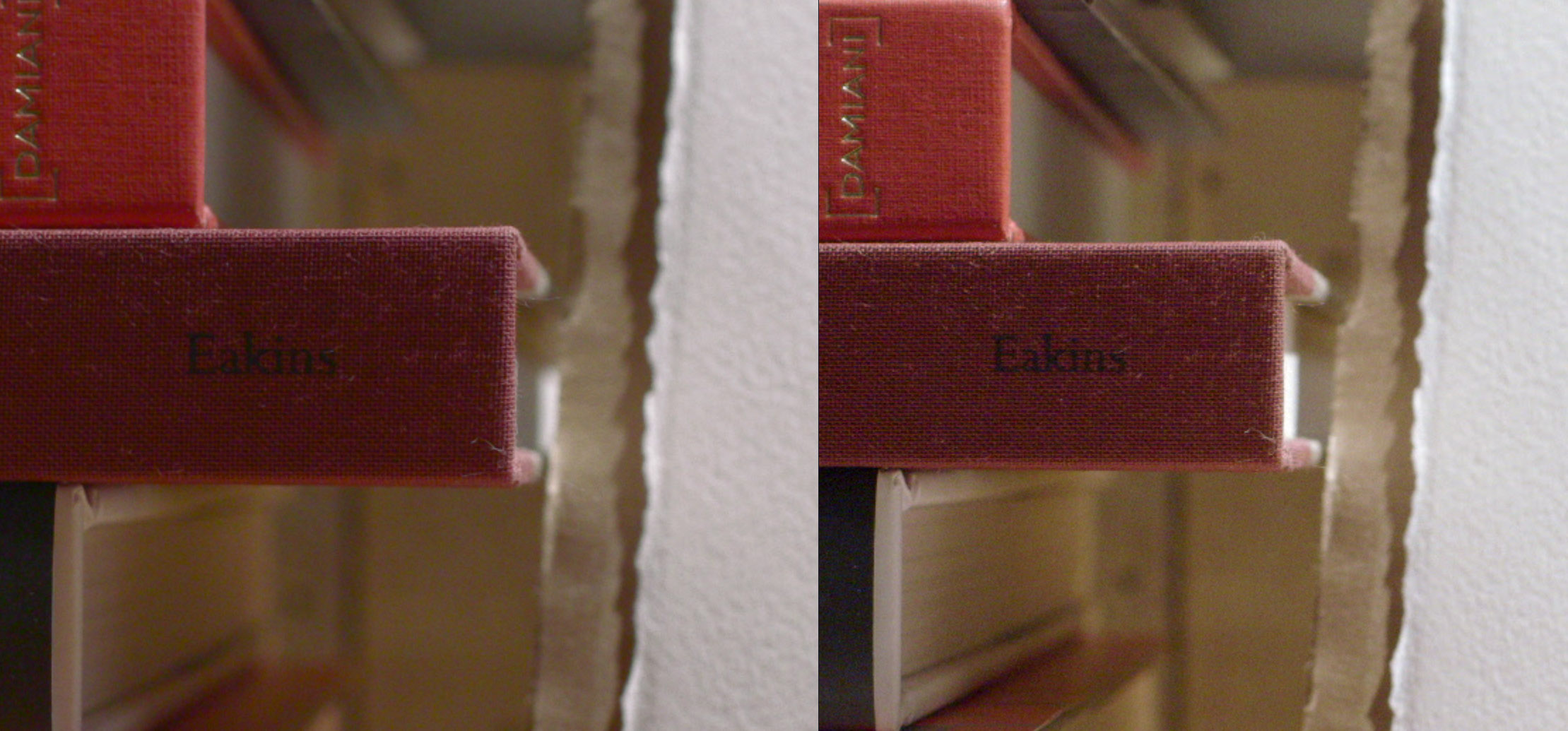

Originally Posted by Sabyasachi Patra View Post
I was about to ask you for a comparison of high ISOs between C300 and C300 II.
This was a quick side by side I did the first night I had the camera. Halogen tungsten lighting. ISO 20,000 at 200%. Mark II on the left. C300 on the right. Canon Log. (I'm not sure the detail difference in the isn't focus or even a slight lighting change). Noise is slightly more present in the older camera. (FWIW...the CLog2 at 20k is event quieter, albeit shot at lower fstop. The noise is finer and is mostly luma noise. (not happy with the color on it so I'd rather not post an image yet).
