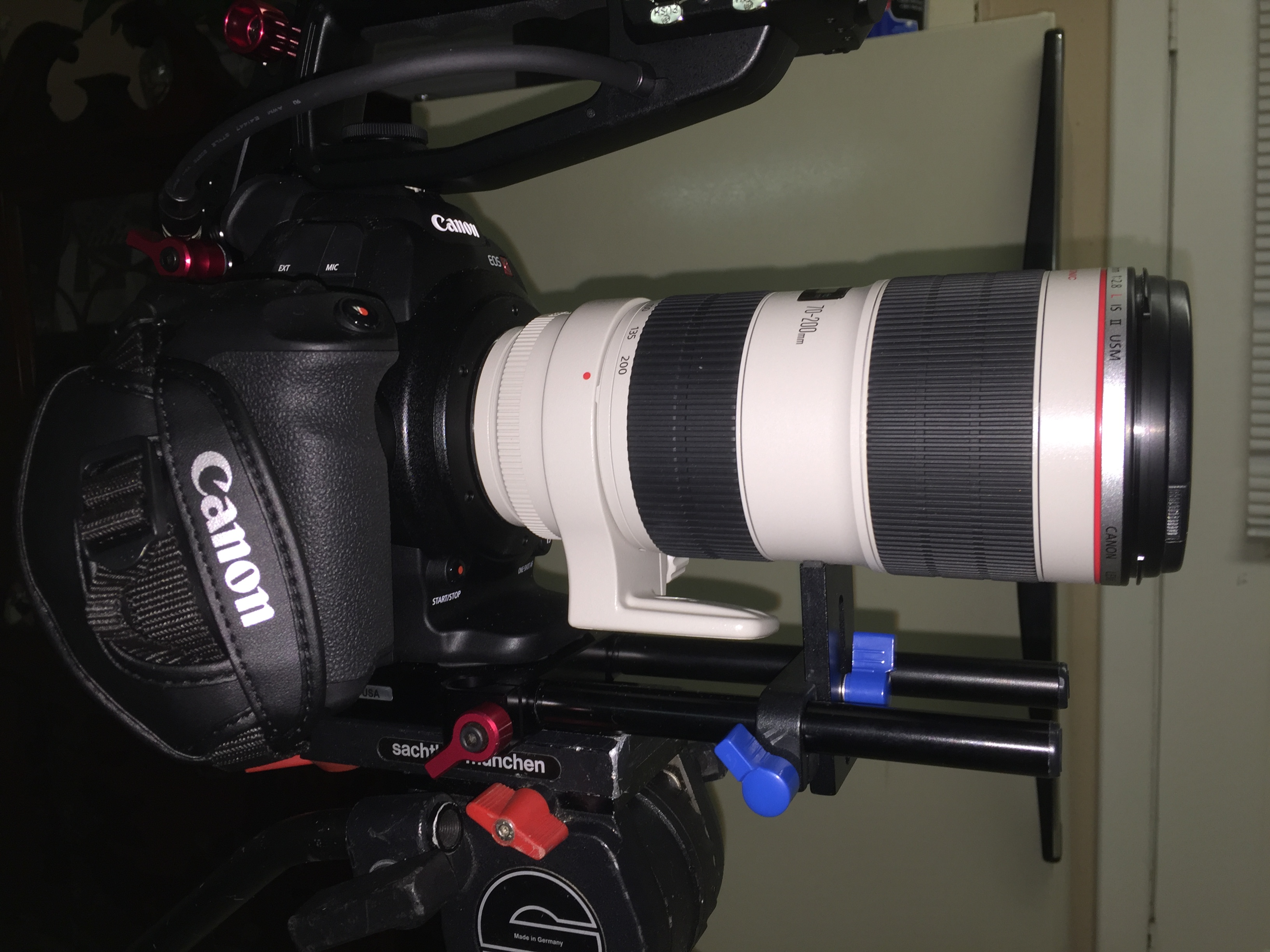

I will post pics of my C100 with support when it's all delivered. As a public service but also 'cause boredom.

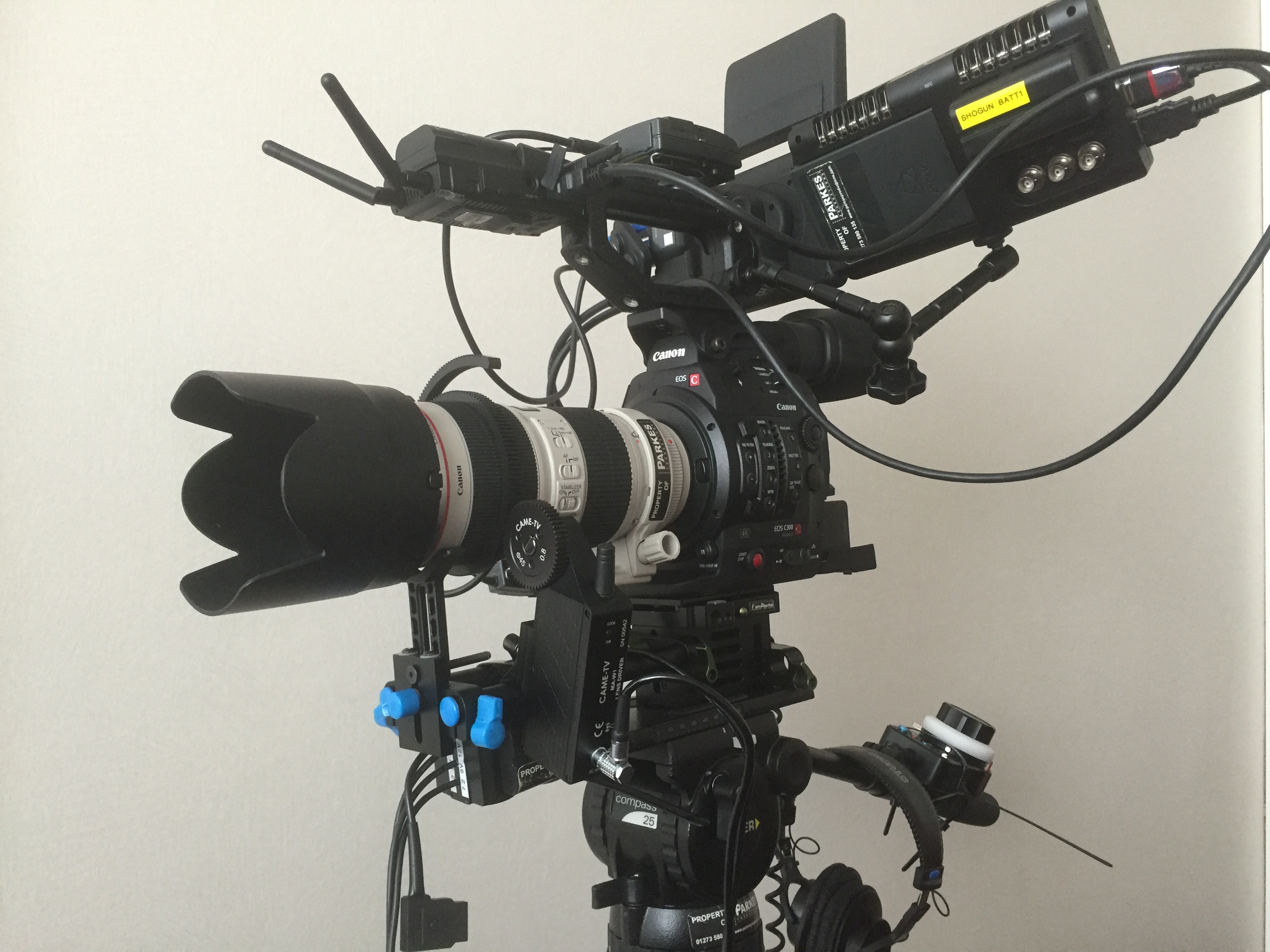

Attached is an image of my C300 Mk2 with the 70-200mm lens, with lens support, while filming in Prague. Also has CameTV wireless follow focus, wireless HD transmitter, radio mic and Atomos Shogun monitor mounted on a Miller tripod. Set up worked really well, and this was an overseas gig, but not always possible when travelling.

My much simpler C100 setup. No the tripod collar mount on the lens is not resting on anything. Yes I removed it shortly after the photo.
