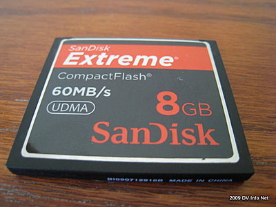

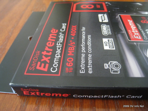

Posts: 27,382

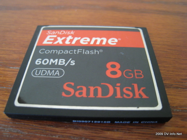

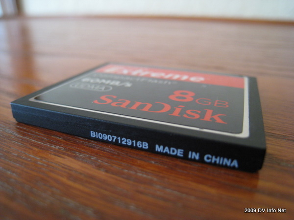

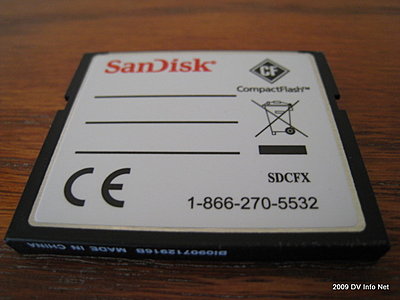

Picked up this SanDisk 8GB UDMA 400x 60MB/s Compact Flash card yesterday ($120)... I'll let y'all know how it goes.
