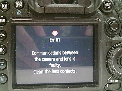

The AF seems to have stopped working and I get this:
"Err 01: Communications between the camera and lens is faulty. Clean the lens contacts."
I tried cleaning the contacts and it still won't auto focus with any of my lenses. Am I pwned?

Well I dropped off the 7D for warranty repair last week and picked it up this morning. The service details were:
"Your product has been examined and it was found that the internal component had shorted causing error 01 to be displayed. The DC/DC PCB assembly, bottom PCB assembly was replaced and product functions were confirmed."
Before the AF stopped working I had used my Sigma 30mm 1.4 on the 7D for a video shoot.
I've read somewhere that third party lenses make the camera work harder, thus causing it to short. Anybody know if there's a truth behind that?
