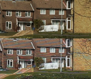

Just don't ignore the aliasing issues that you will encounter with the current Canon DSLR's. Unless you can be sure that your backgrounds are going to be well out of focus aliasing will come and bite you. See the attached pixel for pixel frame grabs to see just how bad it can be. Not only is the aliasing all over the brickwork but its also visible in the bushes and grass in the full frame. T2i at the bottom, EX1 at the top.
The Canon DSLR's are IMHO specialist cameras for shallow DoF, artistic work, the EX is a good all-rounder.

Alister,
It's a shame that the EX1 doesn't capture the beautiful blue and red lines that were painted on those homes.
Jon Fairhurst
Old March 8th, 2010, 07:20 PM   #45
Join Date: Feb 2010
Location: www.faymusmedia.com
Posts: 203
its called anti aliasing....lol
Corey Benoit is offline   Reply
