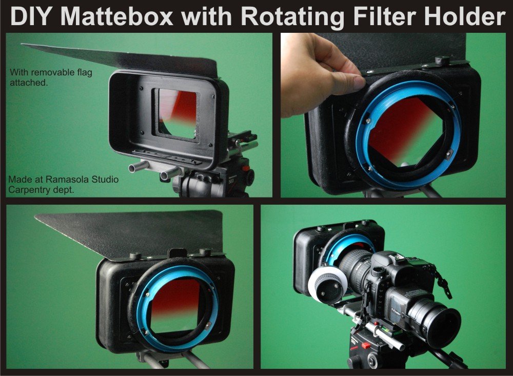

I didn't believe matteboxes were important in the early stages of my career, thats almost 20 yrs ago, thinking I can make do with lens hoods and tape on flags, in short just do it guerrilla style.
However, when I made my lens adapter in 2004, and began using still lenses, I realized how hard it is to flag the wide lenses from flare, the hoods were definitely not big enough. I sat back in the shop and began looking hard at why the film industry uses the MB, I began making measurements and experimenting with flags to simulate the depth of the shade provided by an MB.
I then realized that a typical mb with a top flag can stop flares from light sources or the sun even from relatively low angles not just the high ones.
But one mostly overlooked benefit which I don't see mentioned often is contrast.
In my tests the deep recess provided by the MB adds contrast to an image as compared to a lens protected by a hood.
This is profound on wide lenses, now for those new to this, take note that flares are not just the "common" looking flares that we sometimes use for effects, were you see a series of flare elements whose number depends of the number of glass elements in your lens.
Some flare are so huge that it covers the entire image like haze, you wont know its there since it covers the entire frame. This removes contrast which is subtle in some scenarios.
The MB in combination with a flag and side flaps cuts this down.
This process can be done by flags and an umbrella! But when your out in the field running and gunning doing landscapes, panning shots, moving a lot the MB is essential.
I learned through hard knocks the reason why its important.
I didn't buy one though, I made one. -actually I made two.
So to Charles question, its a Yea for me.
But not in all situations is a mb necessary.

Holy cow, that is really slick, Ted. Thanks so much for documenting your efforts for everyone.
