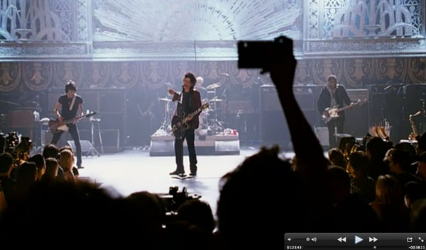

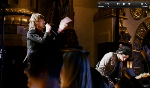

I find the marshall to obstructive for me - I get too clumsy in the heat of the battle! I am mainly a doc film guy. I use this Jag35.com - LCDVF Viewfinder for your DSLR - at $159.
I would shoot some stills with the 7D on day 1 and look at these with the band. This only takes an hour to set up with the band in position and a few friends to stand in for the audience. I storyboard with these for speed. I put them together like an edit on my Macbook right there on the set. This saves loads of time later especially in decision making - lighting, etc.
I would think about a slider or glidetrack or dolly - this looks nice behind the audience in the foreground looking over their shoulders toward the band. Maybe you can build a platform if you have access to the set early - I once rented painters scaffold for only $100/day and this puts you above the crowd.
Rent the Scorcese movie of the rolling stones - shine the light to get some angle ideas - here are frames from my DVD. They shot from low in the crowd quite a bit or up above the crowd - like 12 feet high.
Good luck.
