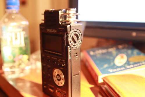

How easy is it to adjust ands use the independent level controls while rolling?
Bruce Yarock
Bruce S. Yarock is offline   Reply With Quote
Old March 24th, 2010, 03:10 AM   #18
Posts: 2,290
Originally Posted by Bruce S. Yarock View Post
brian,
Bruce Yarock
Easy. It's two separate mechanical dials and they're recessed just enough and have the right amount of resistance so they won't get accidentally moved out of adjustment.

I called B+H, got a return authorization for the Zoom. The Tascam 100 will be here Friday.
Thanks, Brian.

You'll also appreciate the double system battery. It has a rechargeable that your usb charges and AA's.

I received my Tascam and will be using it on a shoot tomorrow. From the few quick tests I did, the sound quality is pretty good.

Have you been able to get the on board speaker to work on the Tascam DR-100? I've tied everything with no luck. There doesn't seem to be a menu setting to switch between headphones and speaker, so that leaves only the switch on the back. Am I missing something?
Bruce Yarock
Old April 2nd, 2010, 03:37 AM   #29
Join Date: May 2004
Location: Pembroke Pines, Fl.
Posts: 1,842
Speakers- Just figured it out. You have to go to the input setting and turn the monitor off. Bingo!
