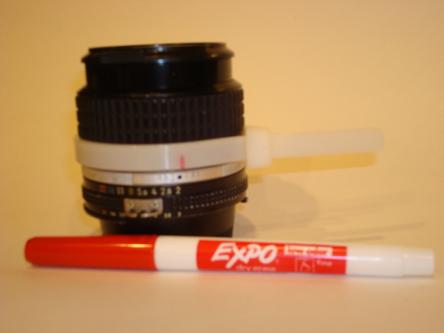

-If you use the white ones - yes, it stands out more, and people know what it is... but the white ones create a dry erase marking surface in addition to making a decent focus lever. The smooth shiny side of the tie should be facing outward and gives an ideal marking surface.

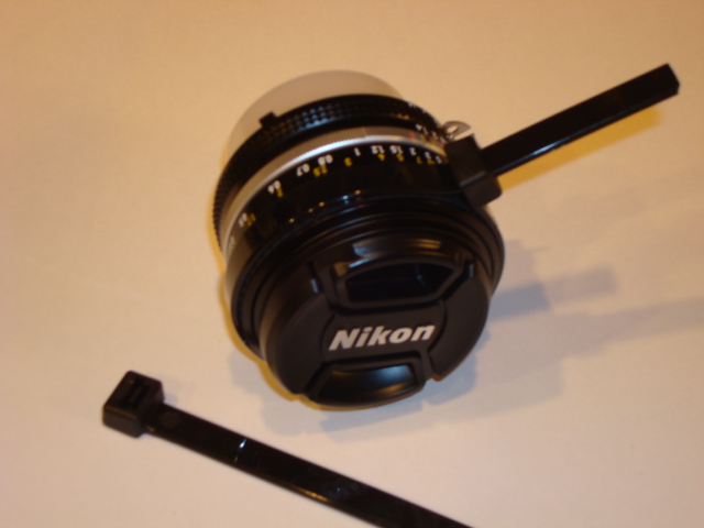

These aren't the greatest pics.....just took a couple of very quick snaps. But here it is. Notice that I have made a mark on the white zip tie with a dry erase marker. Make as many marks as you need and then use the fixed black dot as a static index to all of your focus ring marks. Then just rub it clean with your finger. (The flat smooth shiny finish of the white zip tie is ideal for dry erase markers). Notice the black one cannot be marked on but blends with the color of the lens. The remaining tab after you trim to about 2.5 or 3 inches is solid for focusing. You must use the "heavy duty" zip ties (got mine at LOWES). I can say that this does work as a focusing lever very very well. The only downfall I can find to using these is: A zip cable tie on your lens, looks like a zip cable tie on your lens.
