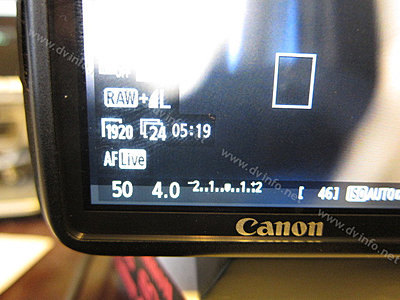

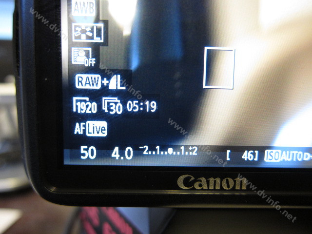

1/50 is indeed available in 1080p30 and 1080p24
(see attached pics), but not in the other frame rates.

Looks like you might have Custom Function 1: Exposure Level Increments set to 1/2 stop.
Change it to 1/3 stop, and you'll be able to hit 1/40, 1/50, 1/80 and 1/100. Hope this helps,

That was it!
