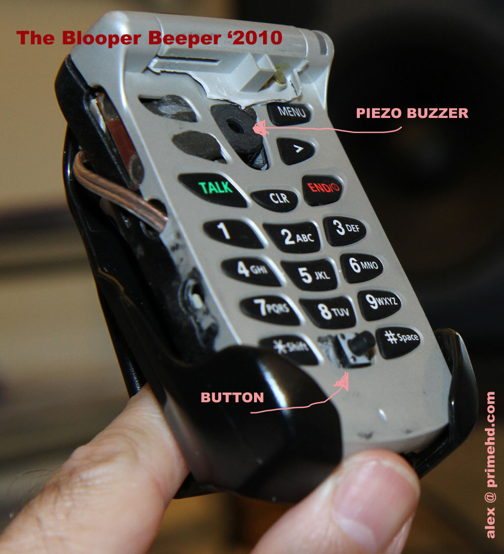

Here's my solution, hope you find it useful.
In short:
- Use EOS utility to set 7D's clock to match other cam's clock
- Shoot at will
- Use Date Created timestamp in the resulting video clips for rough sync in post - and yes, this can be automated (at least in Vegas... still looking for Premiere CS5 automation script.)
- Use Blooper Beeper (see photo of my DIY version attached) during acquisition as clapper board substitute (sans logging) for fine manual sync in post.
Voila! :)
Synchronizing 7D with other video cams in multicam shoot-blooper-beeperv1.jpg
