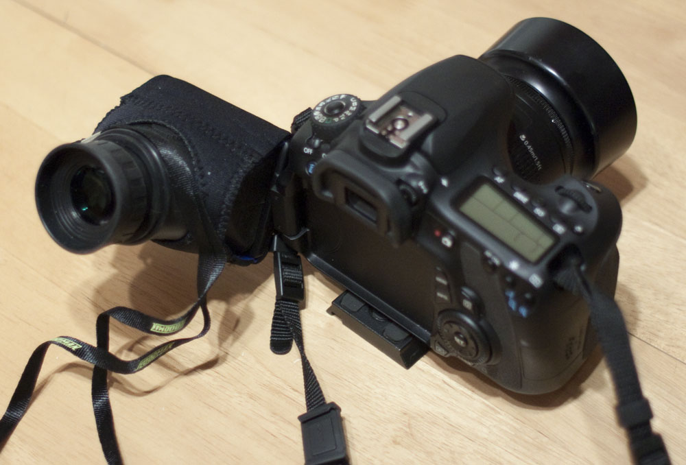

L-Finder
This helps.
If you have a 60D, you have a new option. The L-Finder. It consists of a Hoodman Hoodloupe 3.0 with a Hoodman LCD neoprene strap. Cost $75 for the Hoodloupe from Neal Photo in Montana and $10 for the Strap from Amazon. Total cost $85.
This works well. Other loupes would be too heavy for the 60D LCD in that it would swivel on its own.
http://www.dvinfo.net/forum/attachme...p-img_9976.jpg
http://www.dvinfo.net/forum/attachme...p-img_9980.jpg
