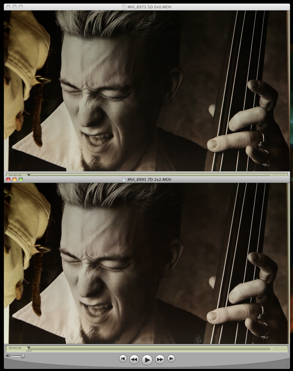

unfortunately a lot of the 5Ds and 7Ds dont have the same factory set colors.
You might have noticed that canon has a unique color character, but often you see the skin tones lean towards orangy or magenta.
Shane Hurlbut ASC. who also works with around 20 5Ds have confirmed this and has individually recalibrated his cameras. His results are more predictable now.
I have also done the same and now my skin tones, reds and yellows are now much better.
Here is a link to his blog on how it is done.
Color Correction: Put Your Best Foot Forward | Hurlbut Visuals
Hope this helps,
Ted

Hey Ted,
thank you so much for that. You've set me on the right road to getting them to match. I've been playing with settings for the past half hour and although it's not looking like it will be easy to get right, I think I can get it 'right enough' to not be a problem when shooting things like interviews in future.
Very pleased! Thanks again.

This is as far as I got this morning. As mentioned, I will try some real world tests later in the week.
