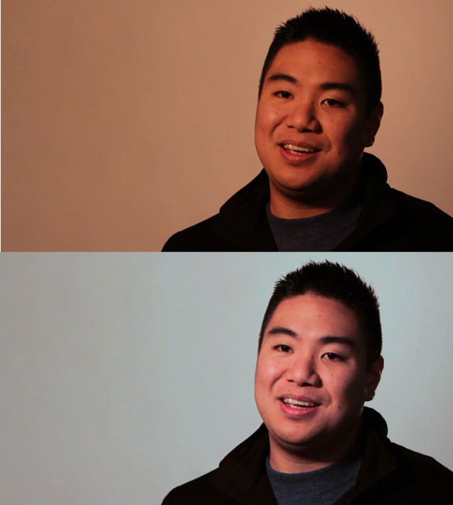

I posted a picture of something I CC'd. Usually I don't CC but the footage right out of the camera (top) was horrible. With a few clicks with FCP's 3-way colour corrector, I was able to get an image I was satisfied with (bottom).
Like others have said, check out some tutorial videos. Here's one that helped me. It's old (FCP3!) but uses the same interface and principles as FCP7. DVcreators.network | Blog | How does the FCP Color Corrector work?
So I definitely think it's worth learning the 3-way first. Magic Bullet is kinda the lazy way but it works for some people especially if you can learn to tweak things and not just use presets. But if you learn Color, you can probably achieve any look you want.

Of course, that's why I added that bit at the end ("works if you tweak things" etc) but perhaps I should have emphasized that more. I'm definitely no colorist so take my words with a grain of salt :p
Perrone and others, if you don't mind a bit of a side topic, can you share if there are differences in the color correcting tools in Magic Bullet vs. [Apple] Color? Or can they pretty much achieve the same thing?
