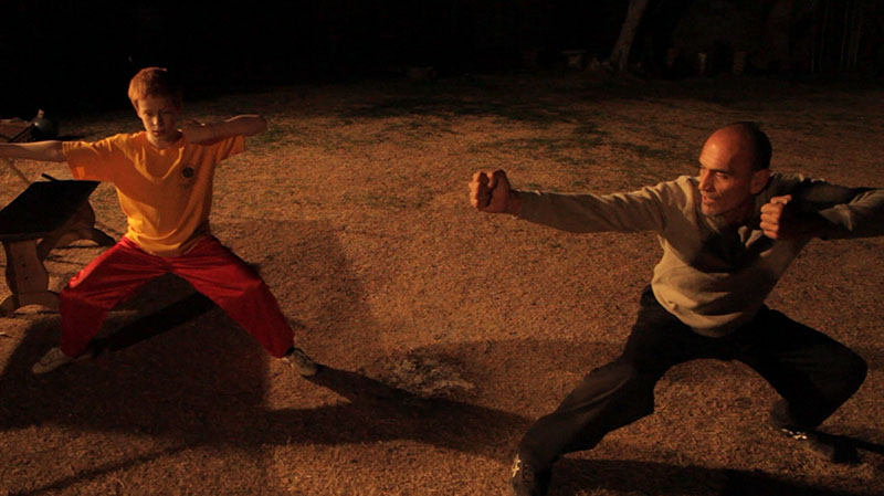

I recently shot in the evening under available light - which was pretty much no light. Not much moonlight and just a small light from a nearby house but it is useable footage. Focusing is much more of an issue than noise really, especially filming a martial arts teacher as I was. This is raw screenshot.
I used min 2000 ISO and went up to 3200 ISO.
