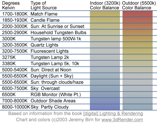

I'll use the presets on the camera. If I have a lot of time, I'll use something like an expodisc to calibrate. The hard part is that when you are indoors, once adjusting for white balance, the image will look cool. I'll tend to adjust the color to amber by two points. If you get way off with your white balance, in my experience, I've never been satisfied with the correction in post, so its important that you get it right. I'll also eyeball it with the chart below (you could add it to your cf card as a cheat sheet to look up on with gigs).
http://1.bp.blogspot.com/_jKmZuAR3Ft.../colortemp.jpg
