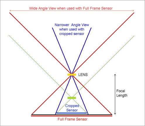

Something that it seems that you left out are the sensor size. Video lenses are capable of wide apertures, but the projection is to a smaller sensor plane (say 1/3" or 10mm), versus the full frame sensor size of a 5d2 at 36mm.
The sensor size relative to the aperture opening is a key factor to DOF,
Simply put... wide aperture to large(wide) sensor equals shallow DOF Narrow aperture to small (narrow) sensor equals deep DOF.
This image (that I borrowed from cyberspace) might illustrate it.
Although the diagram was intended to compare crop vs. full-frame changes to lens focal length. HTH
Edit: hmmm... Forgot to mention focal length affect to DOF. However this is true regardless of sensor size. Longer focal length = shallower DOF.
