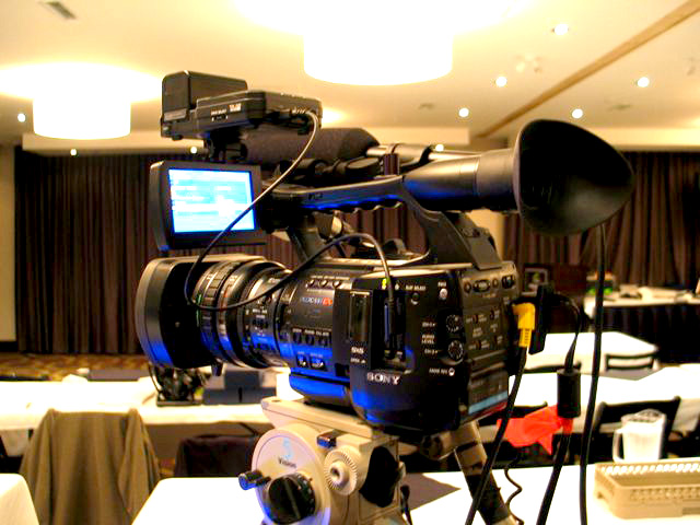

Mike: I didn't have nearly enough SxS cards for a full day, so I got a Sony PHU-120R HDD recorder. I just looked at it, says 421 Minutes available when empty. One BP-U30 powered it for the whole day. Attaching a pic, you can see how it plugs in to one of the SxS slots. An option, but just not sure if it would work on your EX3 (firmware).
