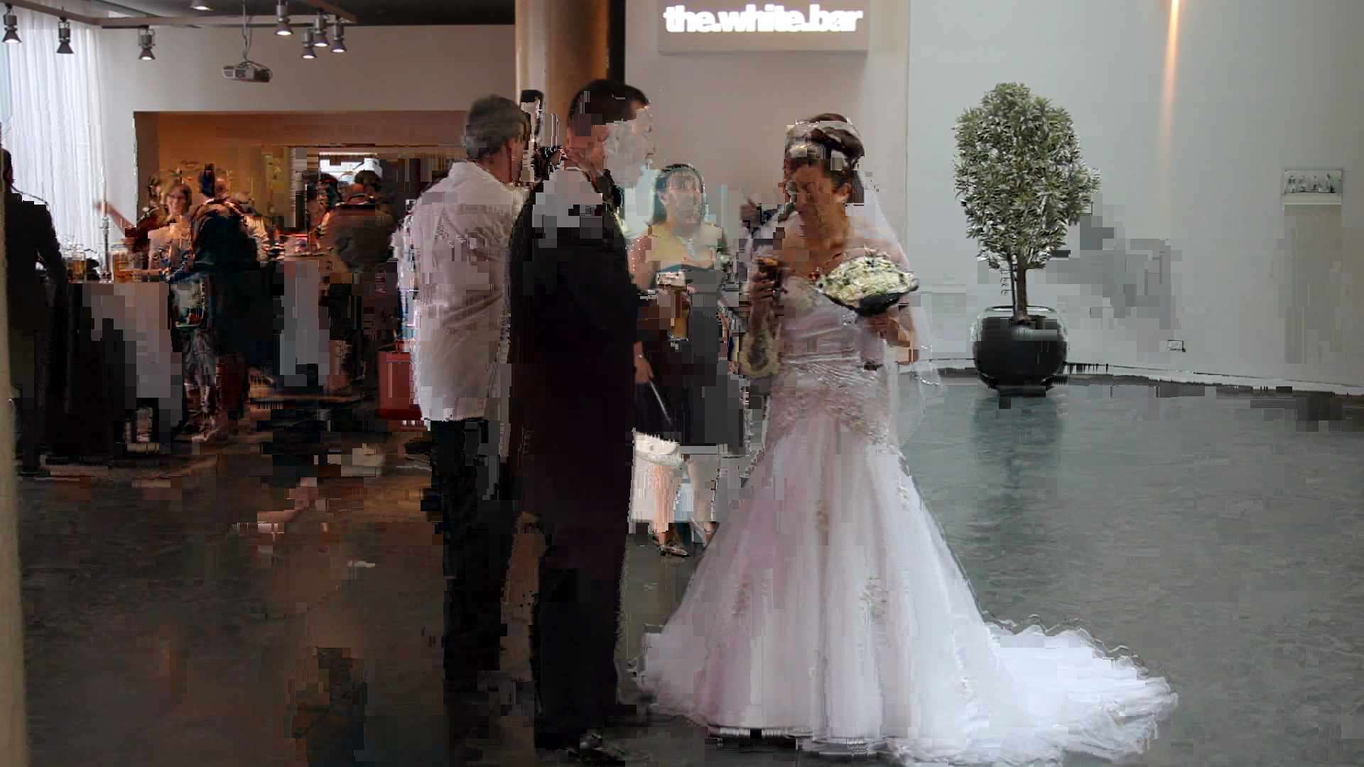

Ok so 2 60d weddings down the line... love it, love it, love it,, but.....i have a few gliches when played back, like artifacts?? only on a small amount of the footage, is this the transend cards? the computor is i7 2tb 6 gig ram nividia graphics, or is it the adobe prem 8 wont take the mov? then again from the raw footage i get the artifacts so? will i have to upgrade to cs5 or just use a transcoder like cineform or mpeg streamclip? if i use a transcoder will it keep the full hd footage? ive noticed also that the glitches are around a certain time i have moved the camera ?? steve

anyone know what this is? transend sd card, monitor, software? camera, steve
