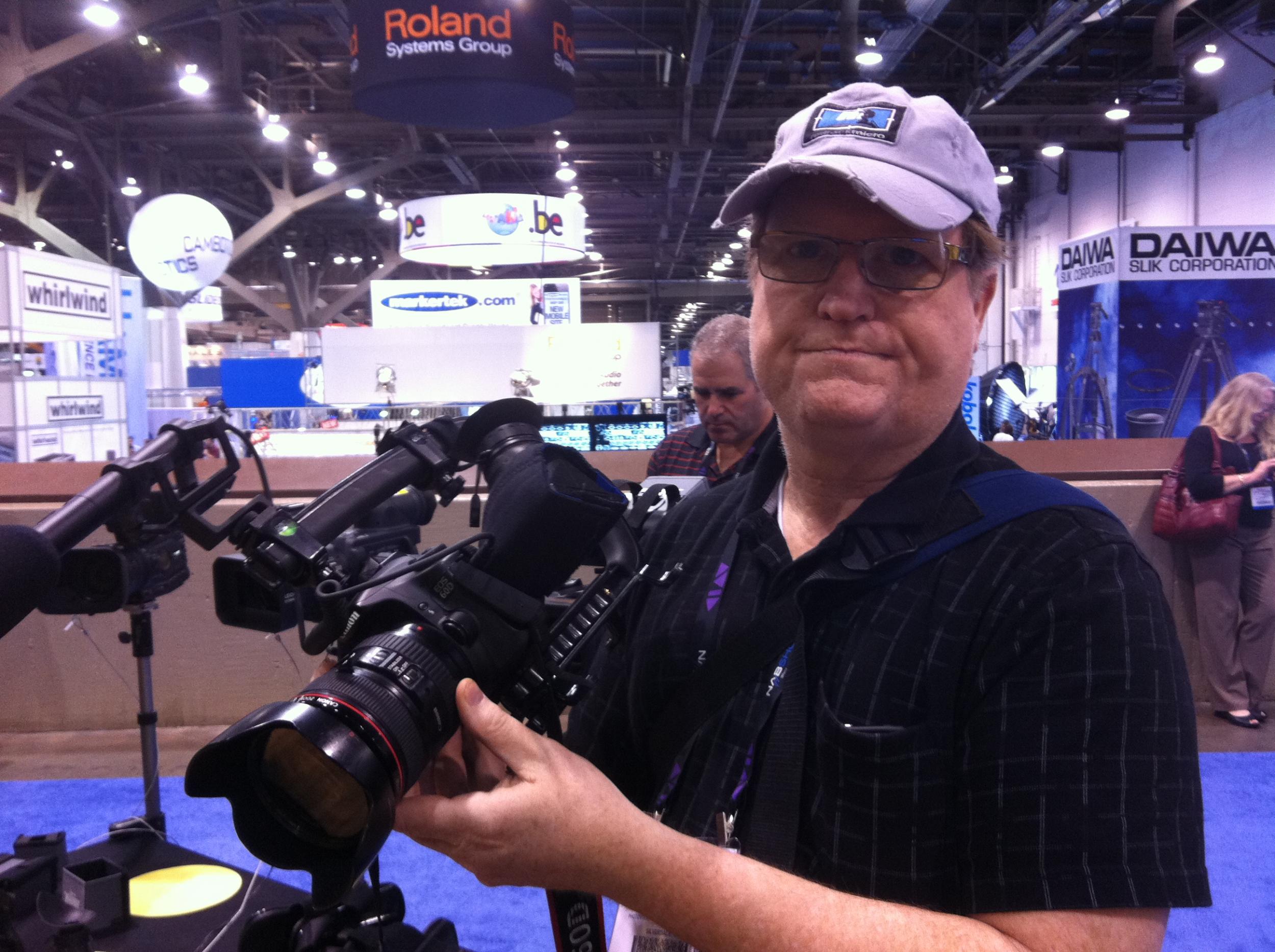

Here I am with my handheld rig. The camera is mounted on a CamCaddie which I brace against my body. I also have a Hoodman Loupe on my flipout LCD on my 60D.
