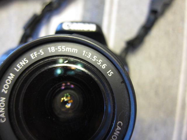

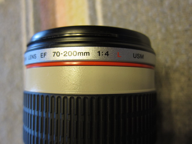

You can always tell by looking at a zoom lens whether it has a constant or variable maximum aperture.
The lens will have its maximum aperture value marked on the barrel. If there are two aperture values,
then it's a variable aperture lens. The larger aperture value (the lower f/number) is the max. ap. at the
wide end, while the smaller aperture value (the higher f/number) is the max. ap. at the telephoto end.
Meanwhile, if the zoom lens is marked with only one aperture value, then it's a constant aperture lens.
See the photos below for examples. Hope this helps,
