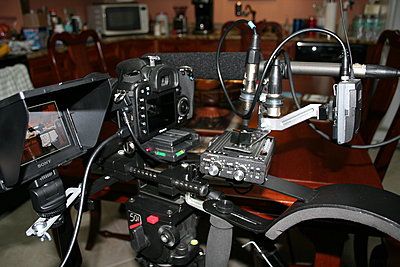

I shot my first event with the 7d Saturday. The video looked great and the audio was good as well.
I rigged up a Beech tec DX6 (I had laying around) with a XLR Splitter sent the signal from my wireless mic to left and right channels on the Beech tec. Set the level on the right to 10 and the left to 5 set the camera to the first mark. That way if the speaker blows out the right the left will still be good.
As I had a chance I would look at the meter in the camera I ended up dropping the level on the right channel to 9. I hate not having head phones to monitor the sound.
The camera rig I have cobbled together is starting to work as I learn to use it. Rigged up it is a heavy rig for hand held work. I will be on a tripod as much as I can.

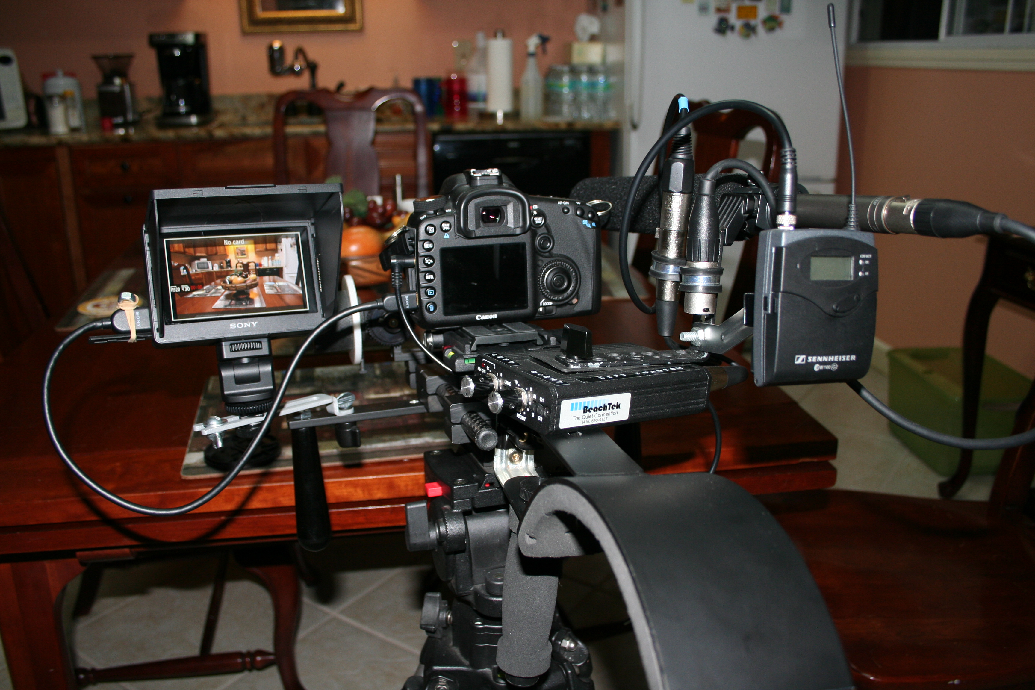

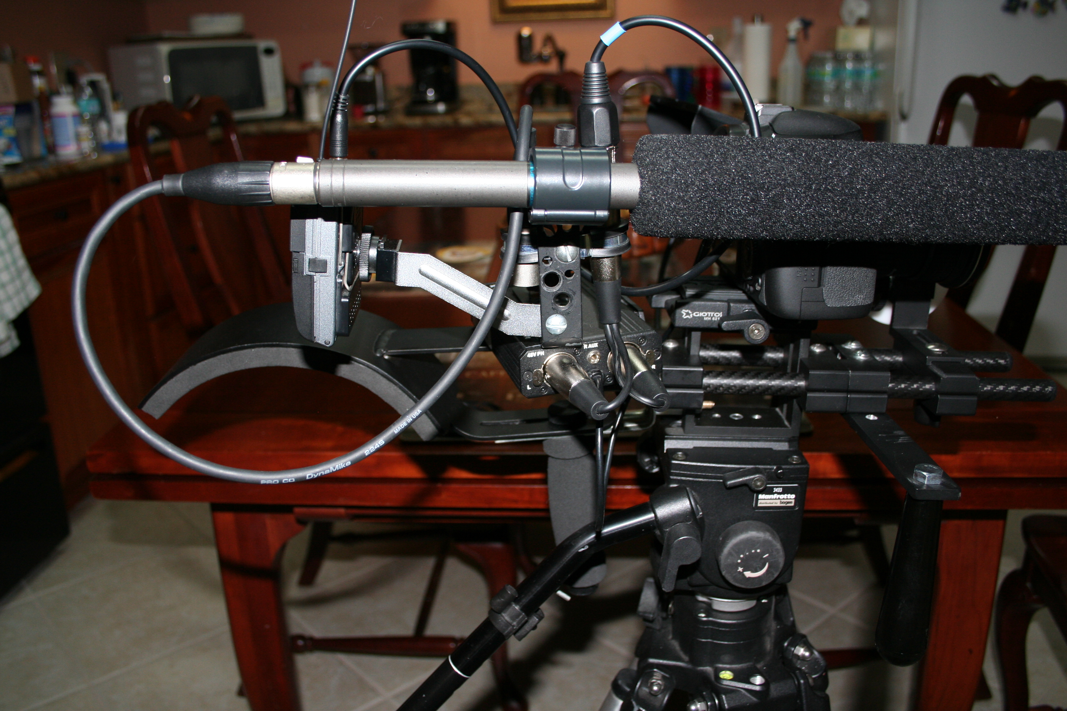

Here are a couple more pics of my audio setup.
