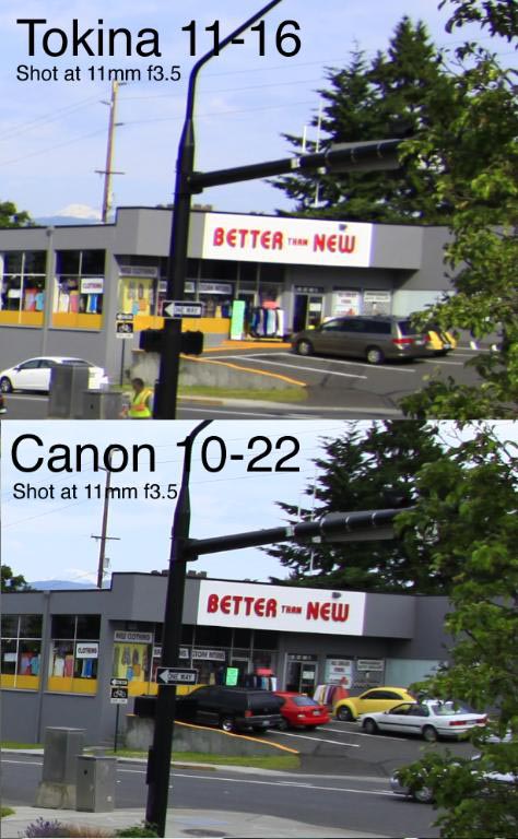

Just to add to the conversation, the attached comparison photo & comment was posted on B & H photo in the customer review section:
Painfully soft
By Peter Pan
from Bellingham, WA
About Me Pro Photographer
I spent HOURS trying to decide between this and the Canon 10-22. I wanted the sharpest lens in this price bracket. I first got the Canon and got sharpness similar to my normal zoom lens (18-200mm). I was hoping for better so I ordered the Tokina 11-16 and did a side by side comparison at 11mm and 16mm at 3.5 and 4.5 respectivly. The center sharpness was about the same, but the edges on the Tokina shot were ridiculously soft. No comparison. I wish I had back all the time I wasted on considering this lens.
Also the Tokina is considerably heavier and the zoom ring rotates the reverse directions that Canon users are used to. Similar: Canon 10-22mm
