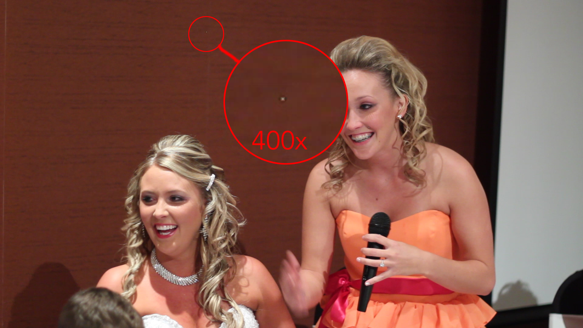

I have the same thing on my T2i. It doesn't show up until the camera has warmed up a little. It seems to be appearing sooner and sooner when I shoot though. I haven't looked into repairs yet.
I just shot a wedding, and I see the white "dot" in footage that I know was shot after I had been using the camera more or less non stop for a few minutes. The dot disappears on footage shot once I had let the camera cool down for a few minutes. Taking the lens off, opening the battery and memory card doors and removing the battery and memory card MAY help to speed up the cooling.

Here's a screen grab. It's always in the same spot (after I've been filming for a while).

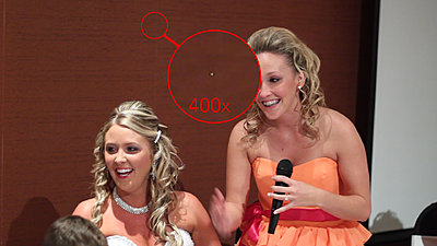

And here's something I shot on July 4th this year, and you can see the white pixel here too. Actually, just watching it now, looks like I have 2 stuck pixels--one white and one blue! Neither is visible all the time.
The video is more or less edited in the sequence I filmed it in (it goes from day to night). You will notice the stuck pixels are not visible at first. The first time you see them is at about 1:20 mark, by which time the sun was going down, and I had been filming for a while.
Also, on that evening I got several over-heating warnings, and I had to let the camera cool down for a bit (it was very hot on the 4th, even at night). So I'm assuming the pixels are related to the heat.
