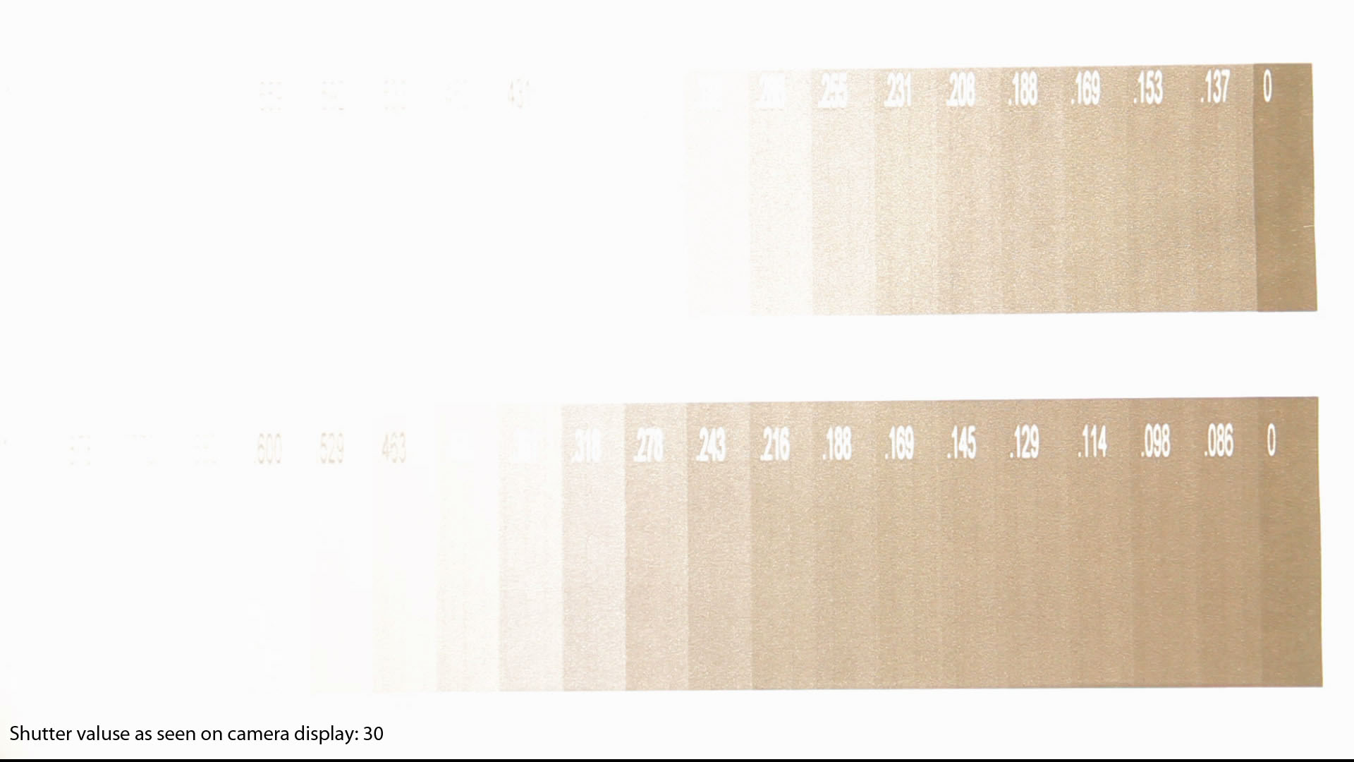

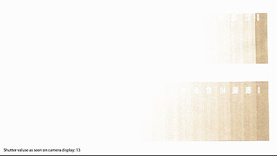

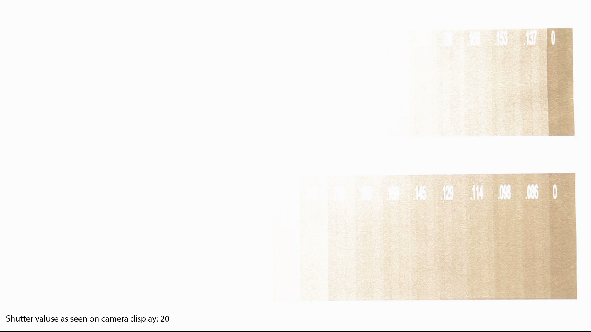

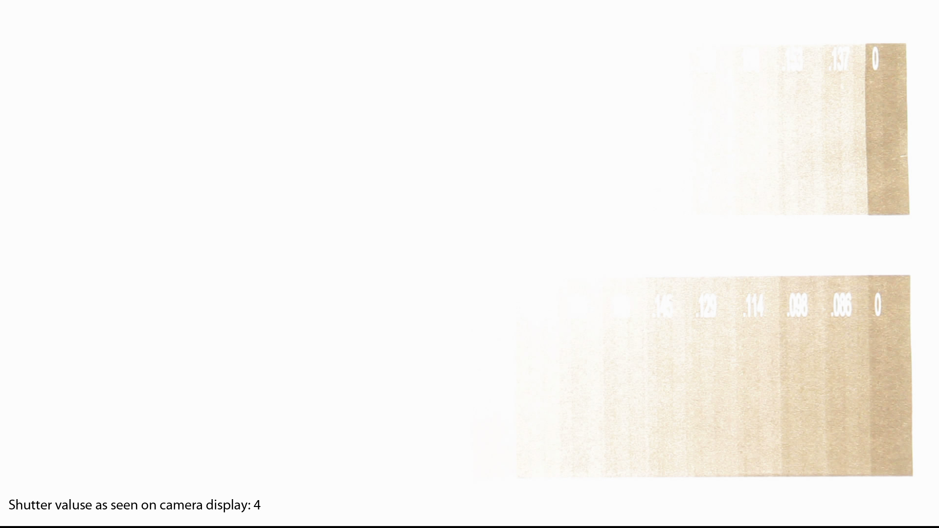

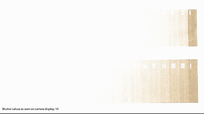

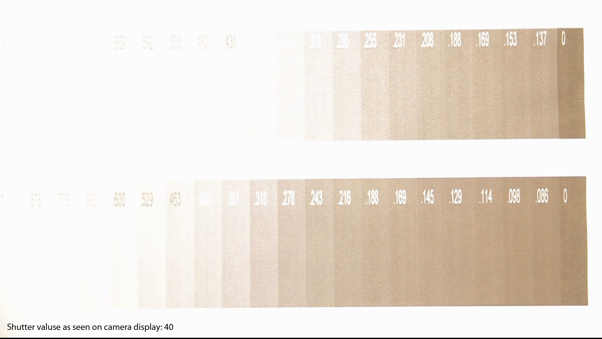

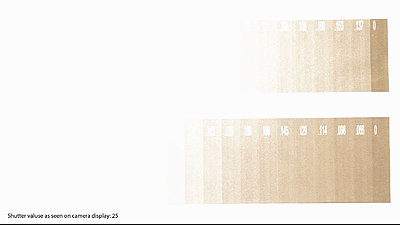

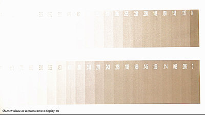

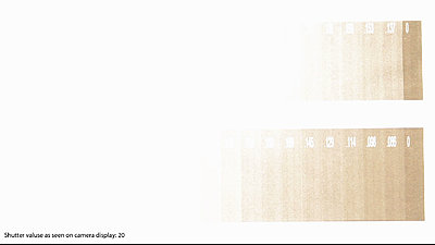

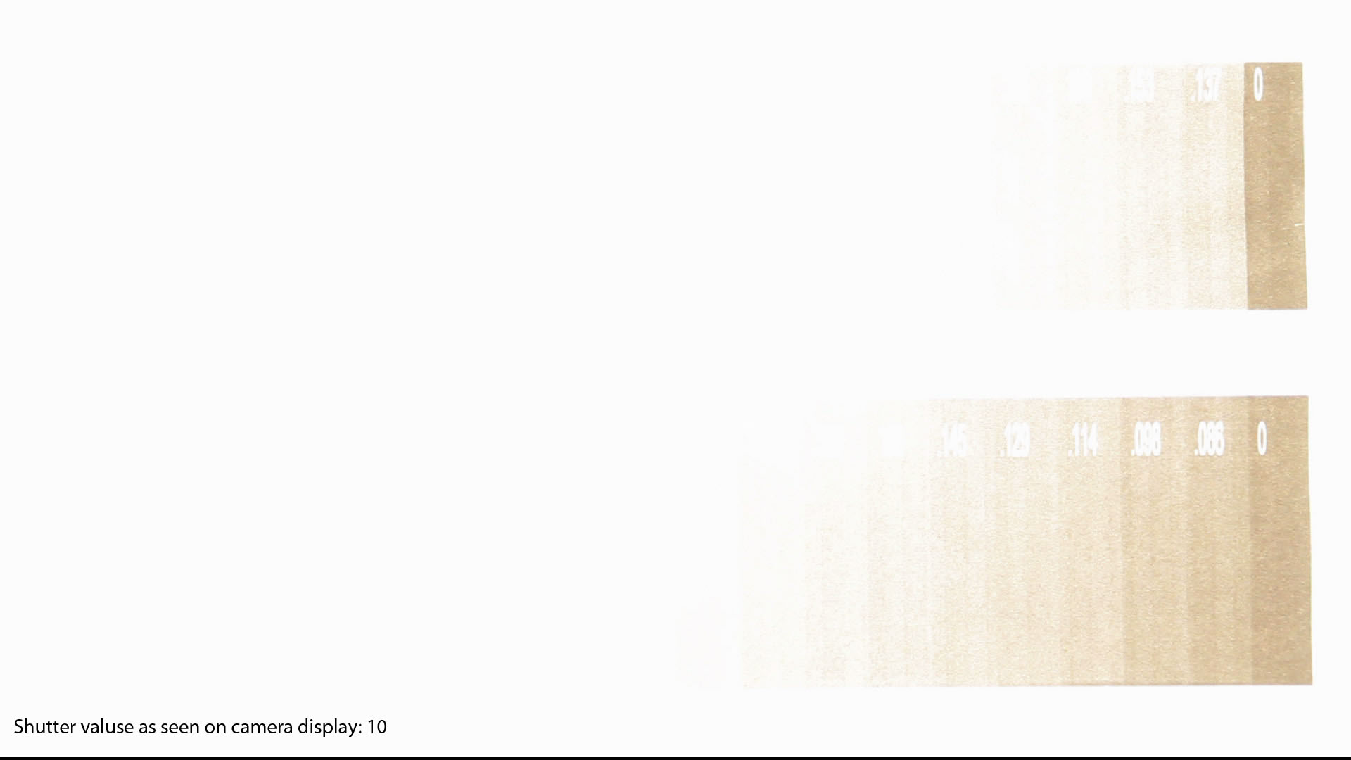

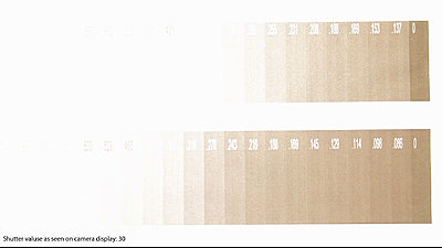

Just took the time to do some quick tests. I don't have any charts here so I just printed something. Its only meant to demonstrate exposure with different shutter values.
There is something strange is going on for sure. It must be manipulating the framerate or the values are wrong. I did not try any movement test. One other possible explanation is that past 1/30 it only adjusts gain.
ISO value remained at 3200.

You might be right about only manipulating gain. From my tests of 1/60, 1/80 and 1/100, the smear is the same for all three, but the gain varies.
The LCD display only shows up to 3200, but according to the instruction manual (page 123):
For movie shooting, the ISO speed is set automatically. ISO 100 is set as standard, then it can increase up to ISO 6400 (expandable to H1: 12800) for low-light conditions.
When you enable ISO expansion and shoot in low light, you'll see that the image brightens even more (as the LCD shows slower than 1/30 speed) but becomes noisy.
If the LCD shows around 1/15, it's 6400.
If it's 1/8, it's 12800 (if ISO expansion is on).
But the actual shutter speed is 1/30.
Anything above 3200 becomes noisy, so I try to keep my shutter speed (indicated on the LCD) not dip below 1/30 (by underexposing using the exposure compensation dial).
