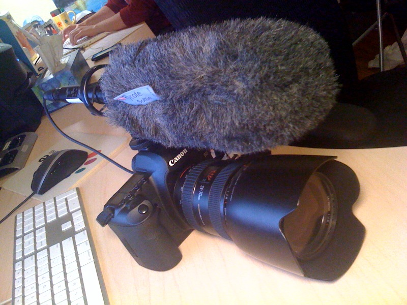

Old January 4th, 2009, 04:46 PM   #8
Location: Geneva/Toronto
Posts: 42
I just tried out the ME-66 and it sounded great. It's just a little bulky on the top of the camera though.
Jesse Morgan is offline   Reply With Quote
Old January 4th, 2009, 05:29 PM   #9
Location: Cambridge UK
Posts: 2,853
Looks good! One other (cheaper) option might be a Rode Videomic and a deadcat for it (i.e. it's self powered, has minijack plug and it's own suspension syetem).
Old January 4th, 2009, 06:51 PM   #10
Location: Portland, OR
Posts: 949
This is what I'm using. Be aware that the suspension system sticks out about 2-3 inches past the rear end of the camera, blocking the optical viewfinder. This is not a problem for most as the OVF is black during video anyway. One solution would be to mount the microphone with a bracket of some sort (higher and away from the camera noises).
