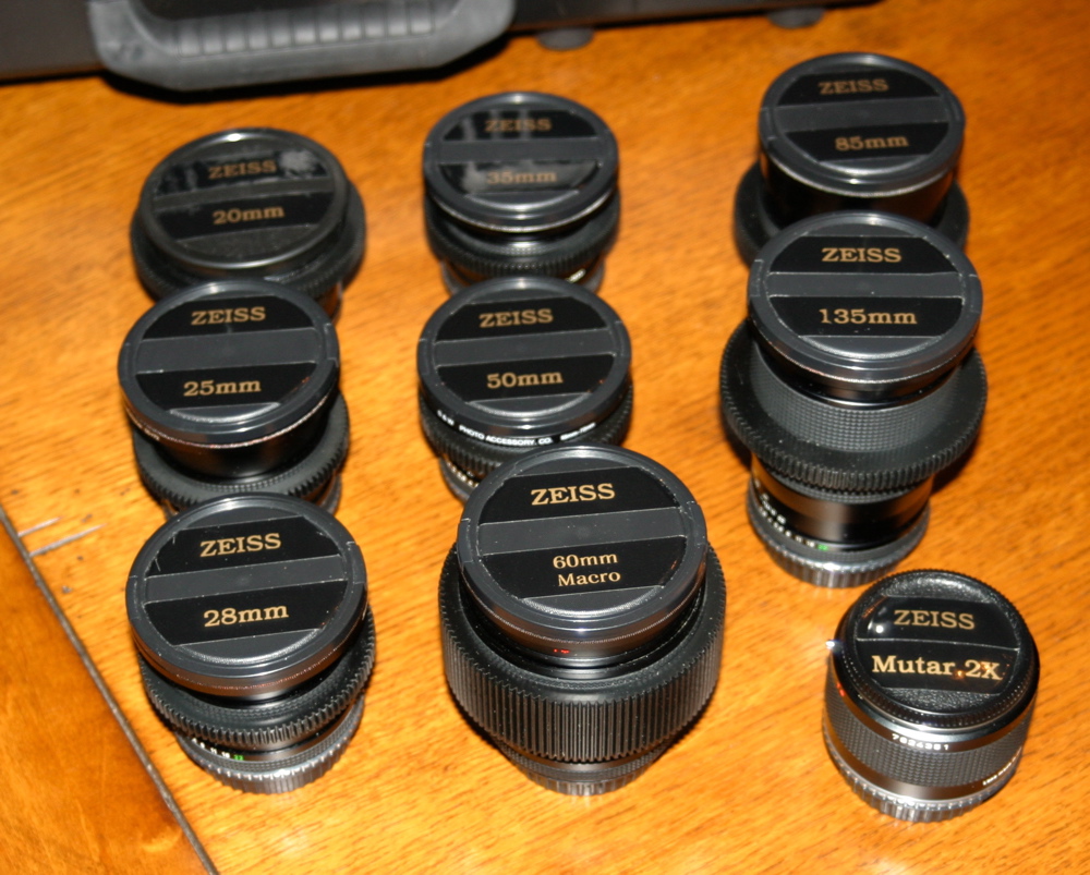

Originally Posted by Chris Klidonas View Post
Well, I am shooting with Stephen Eastwood and a motion picture director, its experimental, 3 cameras, Stephen has a red rock, we need two or 3 more so I am looking at all alternatives as this is more experimental we can try new gear and see what works, whats best, what can improve. At the same time, we will be using a number of L lenses plus the Zeiss for EOS mounts lenses, I cannot imagine trying to do this all without a follow focus, especially on longer glass where the pressure on the lens will cause jitter or shake when rack focusing by hand and blown up to theatrical release size, hell it shows blown up to a 90inch preview screen, at some levels, that is not at all acceptable.
That tells me what I need to know.
If you want the best, get an Arri FF4.
It will last through many different cameras you might use over the years.
The Zacuto is also a great product vs money spent.
I'm not a huge fan of the Redrock Micro unit.
You will need an adjustable rail system with a couple of sets of rails, for shorter lenses as well as longer lenses which require a lens support.
If you are going to use Canon L glass, you will want to use lens gears that will allow a 360 degree movement.
I recommend avoiding the cheaper gears available from Redrock & Cinevate.
Have delrin gears pressed on by a qualified lens tech.
Here are a couple of my lenses with gears.
Good Luck with your project!
